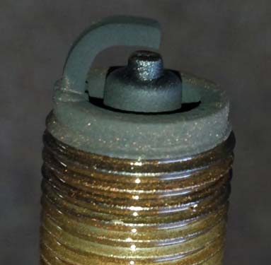

Well plugs looked like crap, they had carbon and wet fuel on them (last time the fuel pump was turned on was 24 hrs before). There is good spark. I took the wide band O2 sensor out and cleaned it. It was also wet with fuel. I cleaned (sanded) all grounds. Oil smells good.
The car was "cranky" and started hard. I decided to get everything up to temperature (nicely) to see if that would clean it out some. I "throttled" the fuel pump to keep too much fuel from going in, which seemed to help. It has begun to work better but still has a unknown issue. It has chewed through a fresh tank of fuel in 80 miles, so I think it is a fuel problem. Or the timing has gone way off, I'm still trying to get a timing light to check (mine is in storage). ...dang I forgot to check the O2 sensor reading when it was hot.

Got it, replace. It will take a few days to get back to it. What makes a plug go bad in 2000 miles? I thought I would get a bit more life out of them. I might be opening a can of worms but what is a good plug? The current ones are NGK, I'm not sure of the heat index.
I didn't post the still shot of the wet plug when it first came out. I will try to post later today.

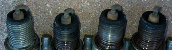

Here are the plugs. I pulled #1 earlier in the week and it looks much better.When I pulled the plug I also pulled the O2 sensor and cleaned it. And yes the shiny threads was fuel.
now the plug looks better. So I'm thinking it is a bad O2 sensor. I am replacing the plugs today. O2 sensor on order.
1-4
5-8
I think the plugs look OK if someone can read them better please post your thoughts. The top left is #1, bottom right is #8. O2 sensor read after the collector by #3 and #4 tubes.
I wish I had blown some compressed air around the plugs before I pulled them. There was a lot of FOD build-up around the hole.

It is too rich. AND are these plugs colder than what are recommended? Sure looks like it. With unleaded fuel the insulators should be much lighter in color.

These are the plugs that came with the motor from KRC. I think the rich look is from a faulty O2 sensor that was dumping fuel in for the last ~75 miles. New plugs are going in 5 minutes.

Rwillia4 Rob pictures helped #6 & #7 plugs look on the money for firing. There are other factor with this issue also. What we need is a spark plug checker. It looks like a flashlight with a magnifing glass to look inside between the isolator the other case. This will tell you heat range being too hot or cold. Gap? I think I read that MSD said to add .010-.015" extra clearance because of the longer more powerful spark. The 2 good plugs I see, look like the opening is facing the intake valve. Every time this is open the air/fuel combo hits the sparkplug and helps keep it cleaner. Degreeing the spark plugs will help keep them cleaner. Like said before, without a choke to help the motor start and run when cold it needs to run rich. Have all 8 stacks been balance with an air flow meter. This meter sits on top of the TWM stacks and measure air flow. Cost is about $45.00 and would get 2 to make it easier to setup. I would go up 1 heat range and I think your motor will be in the ball park. Drive normal and lets see how the plugs look after a couple of drives of 10-15 miles. If you can, Turn on fuel pump and build up pressure. turn off and start motor. there is enough fuel to get it running, then turn fuel pump back on and run like normal. It's better to run a little rich than lean out. If you are really serious about fine tuning the car an A/F meter will be needed and another bung hole put in the other header or side pipe. This way now you have readings on both sides of the motor. This will make it easier to find the sweet spot of the motor and the mid range power will pickup also. Rick L. Ps remember do ONLY 1 thing at a time and test. Plugs and O2 are good step first.
