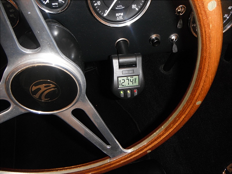

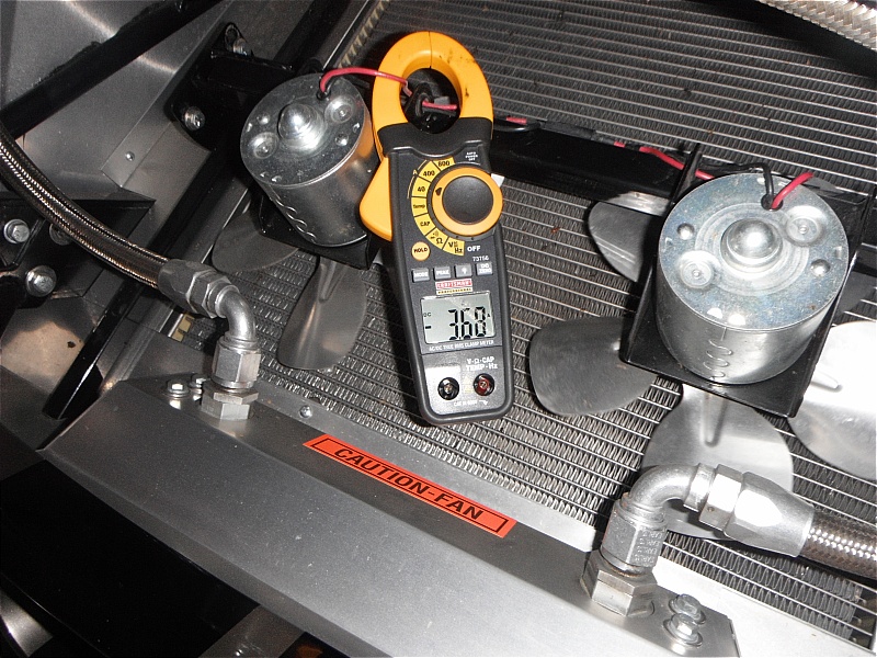

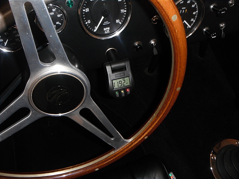

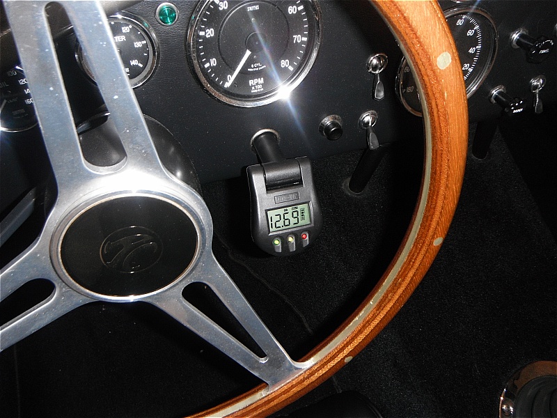

Your alternator only needs to put out 20 amps at idle to handle this job. Here, I keep benchmarks on what my car is doing when it is running perfectly so I can go back and compare when something is amiss. When my battery is fully, 100%, charged I get a reading of about 12.7 volts. When I turn on all my fans (1800CFM puller and dual pushers) the draw is just under 23 amps and the voltage drops to 11.9 volts. I doubt your single big fan pulls as much as my three fans running all together. When I shut the fans off the voltage goes back to 12.7 volts in just a few seconds. And by the way, each pusher fan draws 3.7 amps at this voltage. Now I know you don't have an inductive DC ammeter, but if you could repeat this test and give us your voltage numbers it would make for a good comparison. All of this is done with the car not running, of course.

Yes, from time to time. Mostly I use it as an excuse to buy cool new tools, like an inductive DC ammeter, that I don't really need but have a lot of fun playing with as I take my car apart and then put it back together again, all the while taking photos for posting here on CC.
