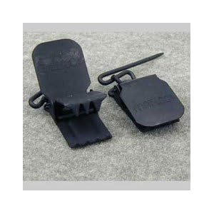

Order a set of the Mat-loc clips. A fellow Cobra owner gave me one and it works like a charm.

Mat-Loc clips work great!

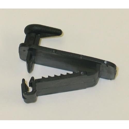

All new cars came out with something like this 1990-2004 Corvette C4 Floor Mat Retaining Clip after mats were pushed under the gas pedals

I've been using the clips from GGBailey for about 5 years. They work fine.

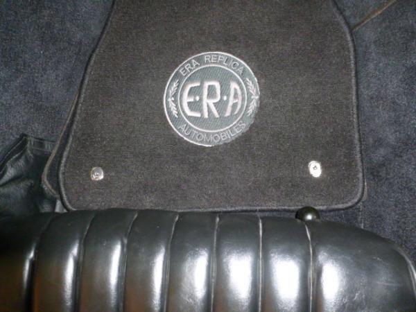

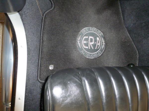

I used Lift-a-dot for the fix. They look the most correct to me. The post are clinched to the carpet instead of screwed into the floor.
