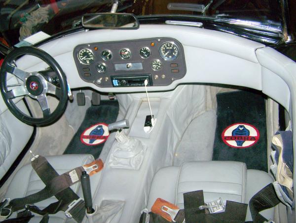

I am 6'1" and my son is 6'4" 250 and 300 respectively, I have a West Cost Cobra and we fit inside fine with room to spare. These car are built 4" wider and 6" longer, the configuration of the seat is very much like a vette and there is enough room for long lengs like ours. If you are interested, ther is one being advertise in Cobra Country, send me a PM and I will give you the link. ALso If you decide for a new one I suggest you to go to a builder and dealer and not the website of the original owner, reasons I will provide in the PM message.
Here is a picture of my car.
Regards Basque1(Lou)
