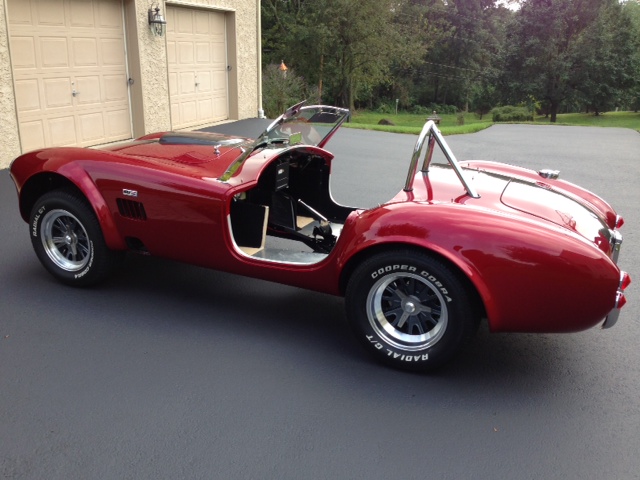

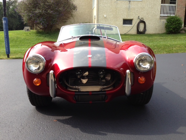

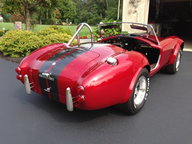

kevins2 08-31-2013 01:37 PM
Haven't posted any updates on the car in a while - still waiting on my motor, which hopefully will be ready for a dyno run by end of next week. Meanwhile, since I can't seem to leave the car alone, I've been doing "busy work" projects like making a bracket and mount for a sissor jack and installing a permanent battery tender cable. Today, I temporarily installed the dash and checked out some of the electrical components. Asked a couple questions in other threads so won't repeat here. Saw that I haven't posted any photos since I got the car on all four wheels, so here's what it looks like now.
http://www.clubcobra.com/forums/pict...ictureid=10694
http://www.clubcobra.com/forums/pict...ictureid=10695
http://www.clubcobra.com/forums/pict...ictureid=10696
http://www.clubcobra.com/forums/pict...ictureid=10697
fjrgary 08-31-2013 02:10 PM
car is looking great, you are doing a excellent job with the build. let us know how the big side oiler does on the dyno.
FWB 08-31-2013 02:58 PM
looks real good Kevin.......post some engine/cam specs...
i heard through a little birdie you were going hydraulic roller?
with edel. heads?
i picked up my motor......Doug did a great job for me...
Murky781 08-31-2013 03:19 PM
Absolutely beautiful!!!
kevins2 08-31-2013 04:42 PM
Thanks Murray, I hope to be using your shop crane soon!
Fred, I will post the specs with the dyno results. The numbers won't impress anyone on this forum as I'm targeting something north of 450 hp, so nothing radical. Yes, I went hydraulic roller with Edelbrock heads/intake. Glad to hear that Doug did well by you. So far, not a negative report on him to be found anywhere...
