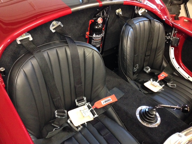

kevins2 11-03-2013 01:01 PM
First start went well and I've put just over 36 miles on it. Had a couple of minor issues (blown fuse for cooling fans - covered in another thread) but am almost ready for inspection. I just need to fix a problem with the right turn signal, put the wipers on and mount the side view mirror and it will be ready to go.
Below are a couple photos of the finished cockpit. Well, finished except for installing the door pockets and aligning the doors. I've been focusing mostly on things necessary to pass inspection and hope to sneak that in before winter.

ERA Chas 11-03-2013 03:48 PM
I'd replace those 2" straps with 3" and put a clamp across the extinguisher so it doesn't become a projectile.
kevins2 11-04-2013 03:53 AM
Hi Chas,
I was considering adding a submarine belt - upgrading to wider shoulder straps would be a good upgrade as well. And, you're right about the extinguisher bracket. I'll either weld a couple quick-release clamps on to replace the rubber bungies or, more likely, just get a vehicle-rated bracket. Want it black anyway...
As you can imagine, getting the car this close to finished is going to make for a long winter. These will be good winter projects, thanks for the suggestions.
Regards,
Kevin
patrickt 11-04-2013 04:43 AM
... and upgrade the cockpit unit to a Halotron extinguisher. I have the old fashioned white powder unit strapped to the roll bar in the trunk and the Halotron unit between the seats. That way, if it's Chas's car that's on fire I use the messy white powder unit, but if it's mine, I use the Halotron.:cool:
kevins2 11-04-2013 05:35 AM
Mine is a Cold Fire unit so, although everyone has their own favorite, Cold Fire is just fine. Hope I never have the opportunity to actually use it...
lippy 11-04-2013 08:46 AM
The car looks incredible. Great job.
I have a portable bottle of Halotron and am trying to decide whether to mount it where you did, or toward the front of the tunnel, behind the vertical tubes. If it is on the tunnel, people may be less tempted to screw with it when parked.
