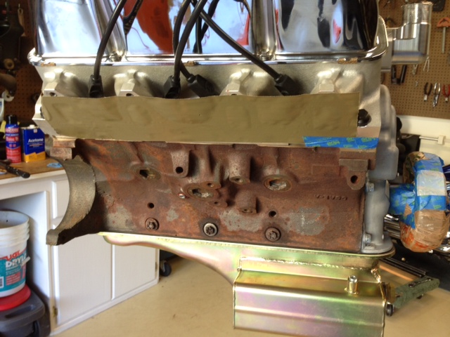

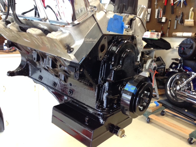

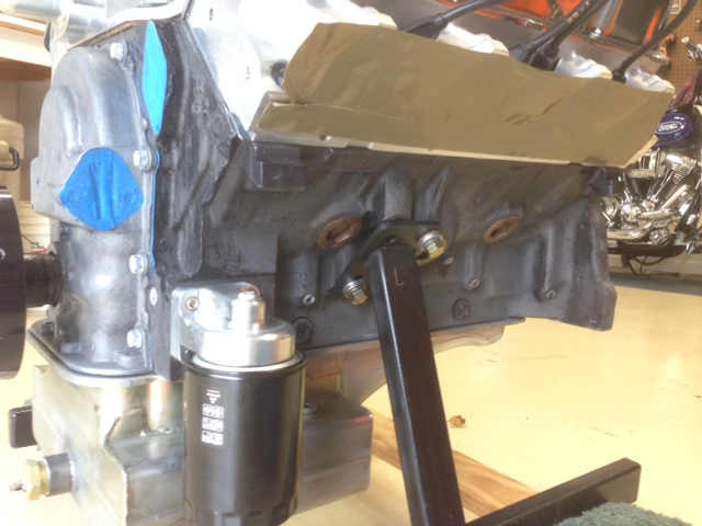

Over the past two weekends I prepped and painted the engine. The timing cover was Ford Corporate Blue, so had to strip that. Then I used Eastwood Fast-Etch, primer and ceramic paint. I decided to paint the oil pan because I had an in-pan oil heater installed and the bung and weld were bare metal. Photos show the progression.
http://www.clubcobra.com/forums/pict...ictureid=10818
http://www.clubcobra.com/forums/pict...ictureid=10819
http://www.clubcobra.com/forums/pict...ictureid=10820
patrickt 09-30-2013 08:11 AM
Is there a timing pointer on there that I just can't see?:confused:
kevins2 09-30-2013 10:07 AM
There is a timing pointer, but I removed it for painting. The tape on the balancer marks the pointer location. There is no play in the pointer when mounting it, but the tape made me feel better :LOL:
patrickt 09-30-2013 10:08 AM
Good enough. It's kind of tricky timing the engine without one....:LOL:
kevins2 09-30-2013 10:14 AM
Yep, I chased the threads with a tap this morning and reinstalled it before getting to work. I hope to get the bellhousing dialed in later this week, schedule allowing. Have a few more small parts on the way - throwout bearing, various bolts, etc. but hope to install it when my son comes home from school for Columbus Day weekend.

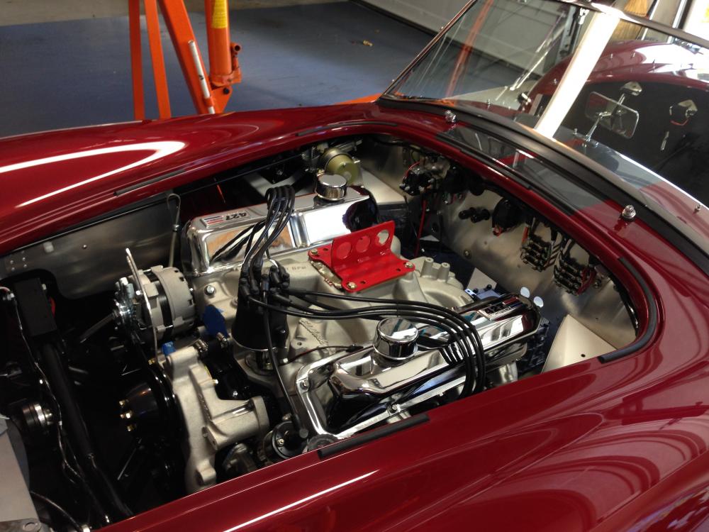

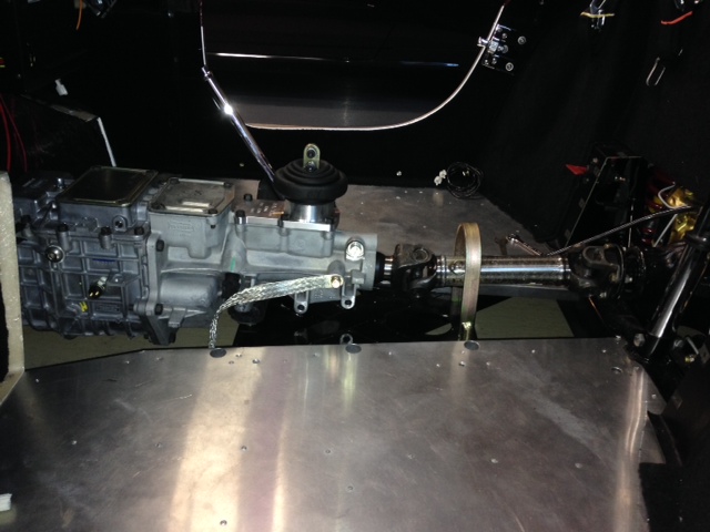

Got the drivetrain and sidepipes installed Columbus Day weekend.
http://www.clubcobra.com/forums/pict...ictureid=10976
http://www.clubcobra.com/forums/pict...ictureid=10974
http://www.clubcobra.com/forums/pict...ictureid=10980
http://www.clubcobra.com/forums/pict...ictureid=10977

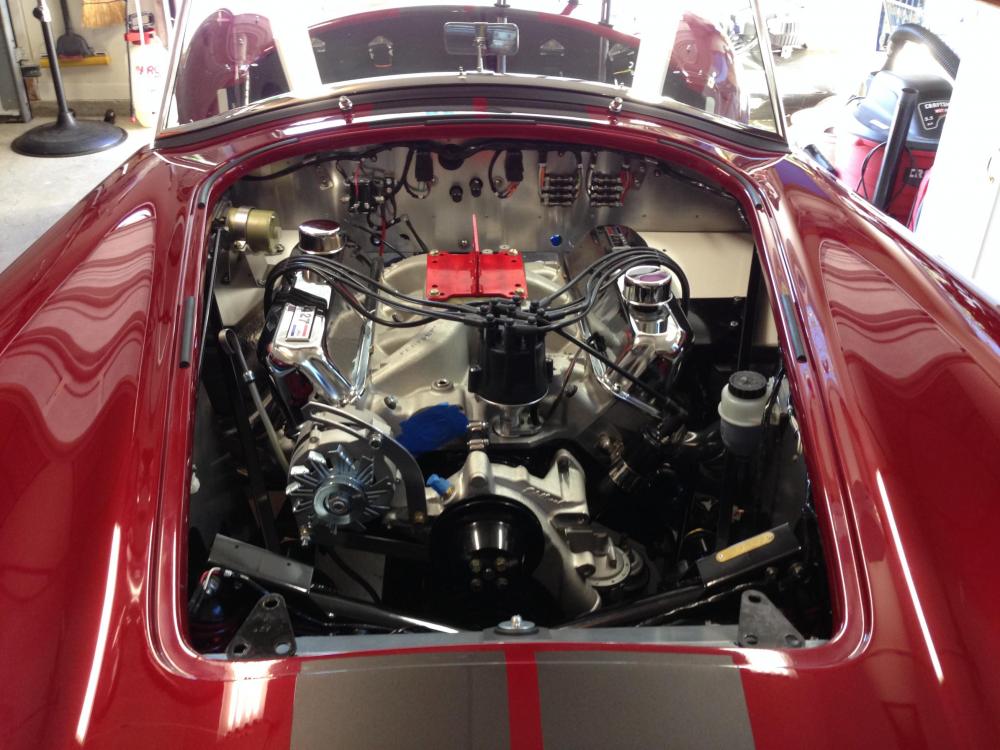

This past weekend, got a lot installed on the engine.
http://www.clubcobra.com/forums/pict...ictureid=10979
http://www.clubcobra.com/forums/pict...ictureid=10978
patrickt 10-21-2013 06:15 AM
It looks like it's almost ready for the first short "quickie" ride around the neighborhood -- just to see if it actually can run under its own power.
