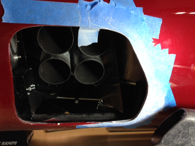

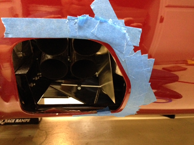

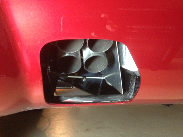

When I installed the engine, it was possible to move it forward and back a bit in the slotted chassis mounts to get the side pipes centered in the body opening. Had it looking good but after driving it a bit, the engine found its own sweet spot and the driver's side was a bit closer to the back of the body cut-out and ever so slightly singed the paint (you can see in the first photo where it singed the paint on the upper portion of the trailing edge of the opening). After consulting with ERA, the recommended procedure is to enlarge the opening. I enlarged it about 1/4 inch and managed to make a nice straight, clean edge with no damage to the paint. I then touched up the inside edge with primer and paint and it came out perfectly. The first photo shows the opening taped off where I wanted to enlarge it, the second shows it cut out up to the tape and the third shows the result.

What tool did you use to cut the opening? It looks good.
kevins2 11-29-2013 08:40 AM
Thanks Lippy,
I was very pleasantly surprised by the outcome. I used a rotary tool and bought a cutting attachment for this job. However, I then found that a medium grit drum sanding attachment worked better and the larger diameter of the drum sander was perfect for the corners. I used a half-round file a bit as well, but that was very minimal. I used a higher speed until getting close to the tape and then a slower speed for the finish. It was considerably easier than I expected. In fact, taking the sidepipe off and on was a bigger pain.

Very nice job Kevin. Taking those slip joint collectors apart are a pain. I'm using the recommended Walker sealer on mine but I don't think it makes it easier to take them apart.
Dan
kevins2 12-01-2013 06:14 AM
Hi Dan,
I also used Walker's acousti-seal. I don't think it made it any easier to take apart either and had to clean off the hardened sealer for reassembly. But, I'm sure it prevents exhaust leaks. The sidepipe did go on much easier the second time.
Kevin

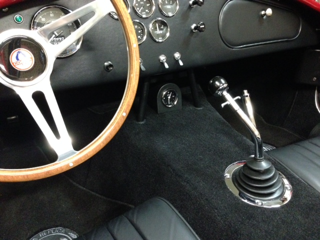

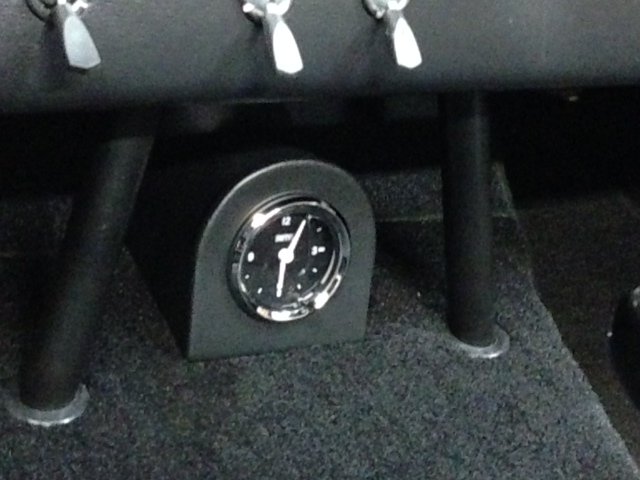

Another project was to put a clock in the car. I always like having a clock but didn't want to clutter up the dash so didn't order one with the car. Instead, I bought a 52mm Smiths clock to match the gauges and made my own enclosure - covered it with black vinyl to match the dash. I made a bracket that clips to the front edge of the tunnel and holds it firmly with no screws or holes drilled. So, if I ever sell the car and the new owner doesn't like the clock there, it can be easily removed without a trace.
