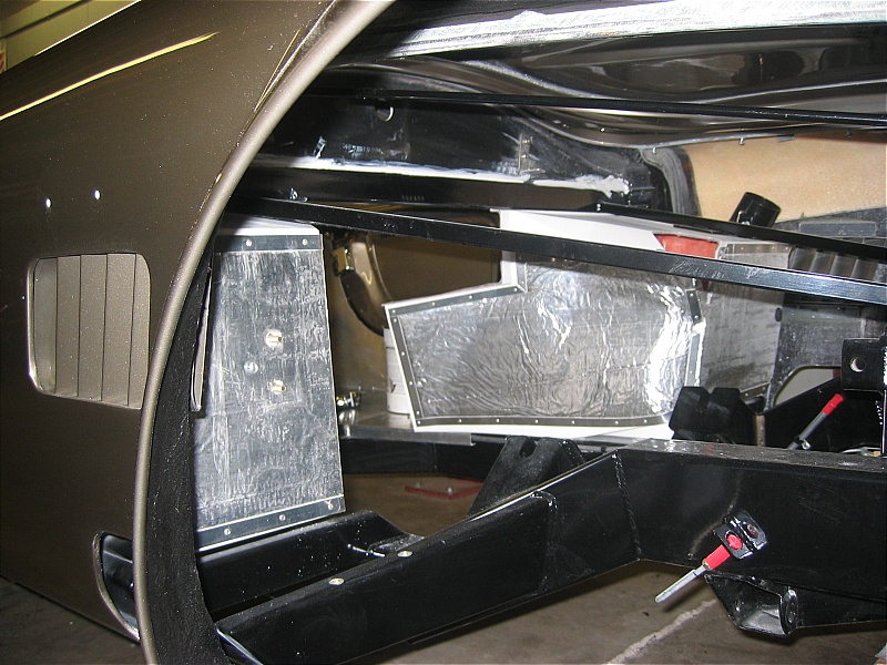

1) Do not insulate the inside of the trunk; 2) Do not insulate the inside of the car; 3) Insulate the front and sides of the foot wells, as seen in the pic of my car below -- this is really the only place you really need to insulate; 4) The underside of the tunnel is purely optional -- I don't think it makes a difference, I don't have mine insulated, and it doesn't get hot on the inside of the tunnel. I've been under there when everything else on the car was red hot, and that area was still not hot.

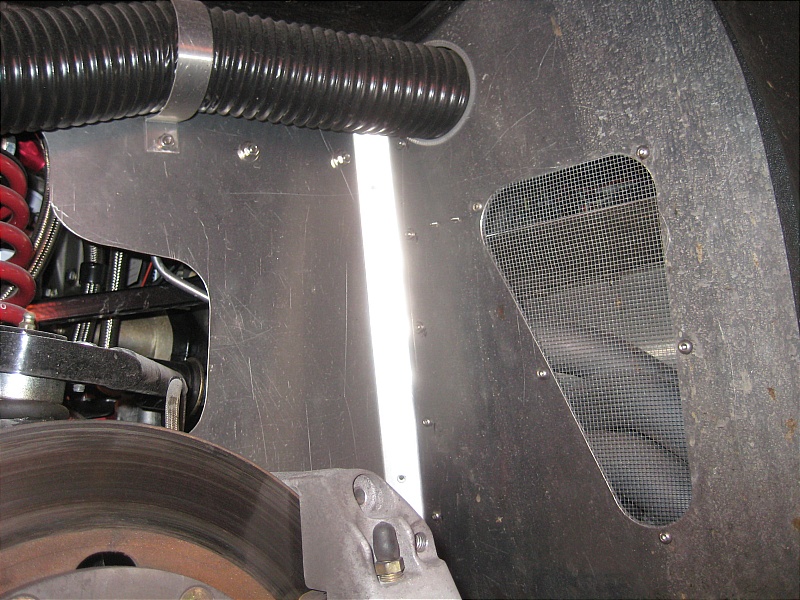

Not another insulation idea but an additional approach to keeping the footwells cool -well, less warm- is to run pipes from the brake duct openings. These are for the most part just screened with some perforated alloy sheeting for the sake of appearance or left alone altogether. Why not put them to use?
I have PVC pipes running from just behind those openings up through the inner guard on each side and then mounting onto the top of the footboxes directing fresh air down to both footwells. It's a straightforward installation, no switches flaps valves etc etc and the difference is noticeable. No rain gets in. I guess if the weather turns really cold you could always just pop some sort of bung into the mouth of the pipes but that sort of weather is foreign to me. Use in connection with relevant insulation of course.

Yeah, those come standard on the ERA cars. Air scoop inside nose But they also have an optional in-line blower seen here: Installing fresh air fans which I don't have, and have always wondered if they really did anything or not. Here's a pic for those of you who are too lazy to click the links.

Both of you mentioned heat shields. I got the wheel well vents but missed the heat shields. I just found them in the manual but the drawings don't really show much and I can't picture what they look like installed. I haven't installed an engine yet, so I assume the heat shields would be pretty easy to add? I can contact ERA, but thought I'd ask you guys since you both have them.
Think of the shields as "upside down L-figures." They're made of aluminum, are custom fit, and each side is different. You can see the shot of my passenger side, through the wheel opening, with the wheel well vent and battery removed. The other pic is of the driver side, with the wheel well vent still there -- so look through the mesh and you can see the heat shield over the pipes. Installation is a pretty easy, straight-forward job... meaning it will take most of the weekend.
