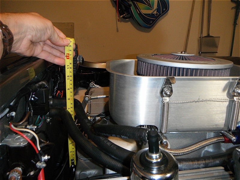

It is the 427 MR, not the comp or dominator version. I measure the distance from the flange to the carb air cleaner acorn nut to be about nine and three quarters inches. Here's a pic with one of my kids holding the tape measure for you (not sure how much that pic helps, but it gave us something to do).

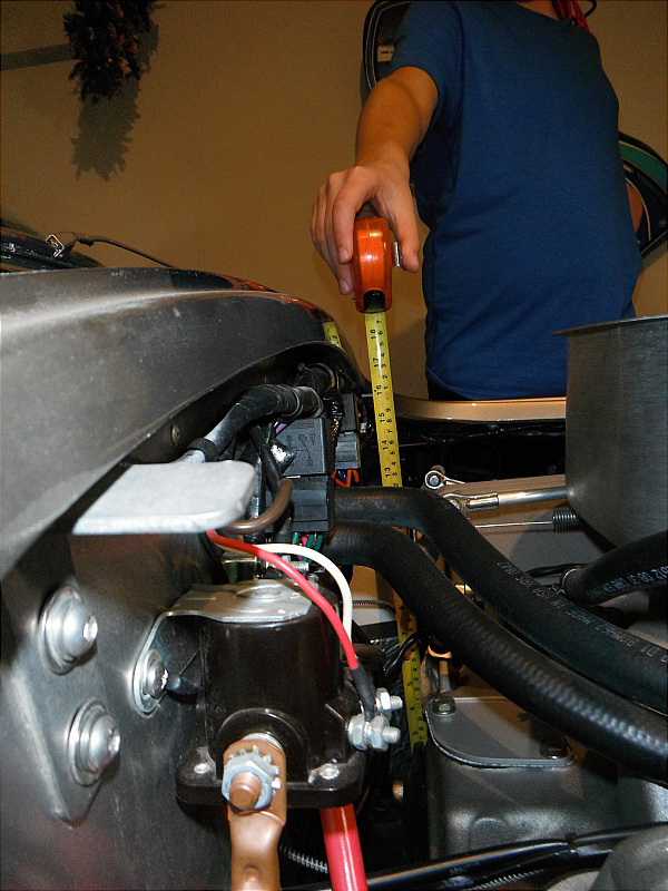

Here's a better one. With the tape measure resting on the top of the block plate, I measure the distance from the top of the block plate (Lakewood) to the top of air cleaner acorn nut to be just under 12 and three quarters inches -- maybe twelve and a half.
