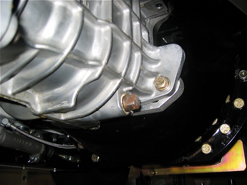

Brent, you're right there isn't that much to cut. But there is something. It looks like you could get an inch or so off it. This is the diagram from the ERA Manual (credit to Bob!) and here are some photos under my car. As I mentioned before, the bellhousing extends below the frame and oil pan by 1.0-1.5". I hope it isn't a problem.

That's all I sell for Cobras because of ground clearance issues. Never had anyone complain yet of them hanging down too low....with Shell Valleys, Kirkhams, CSXs, ERAs, and Uniques.
I would not cut what you have there, as it's not just a lip-flange like the other bells, you would be cutting into the shape of the bell itself and may end up with a hole in the bottom.

I'm using the Aviaid. It is almost exactly flush with the bottom of the frame. How much does your bell extend below the bottom of the frame?
It's about an inch below the frame - and maybe a little more - I haven't precisely measured it. It sounds pretty much the same as yours.

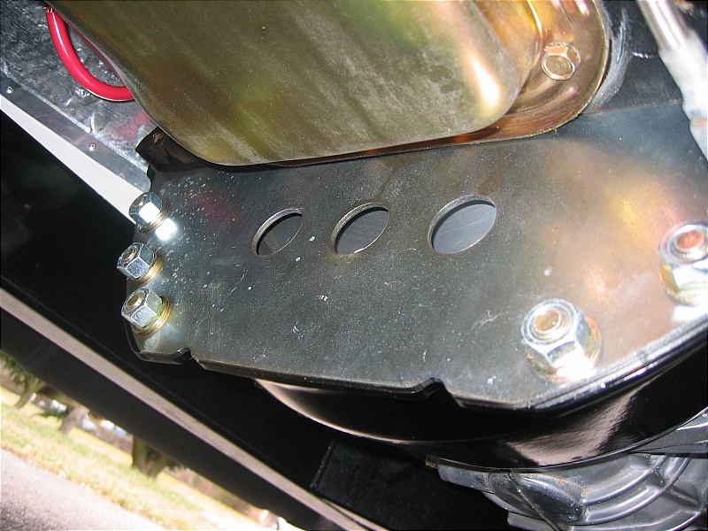

For comparison purposes, my trimmed Lakewood...

My trimmed SFI Quicktime is 5/8" below the frame, so they all are - it's just a matter of how much.
