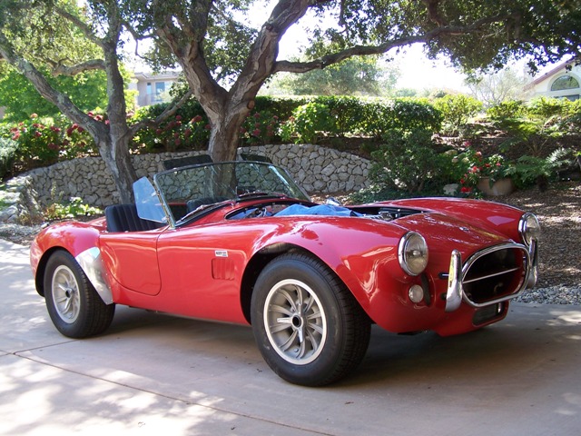

Wheel finish on this car?

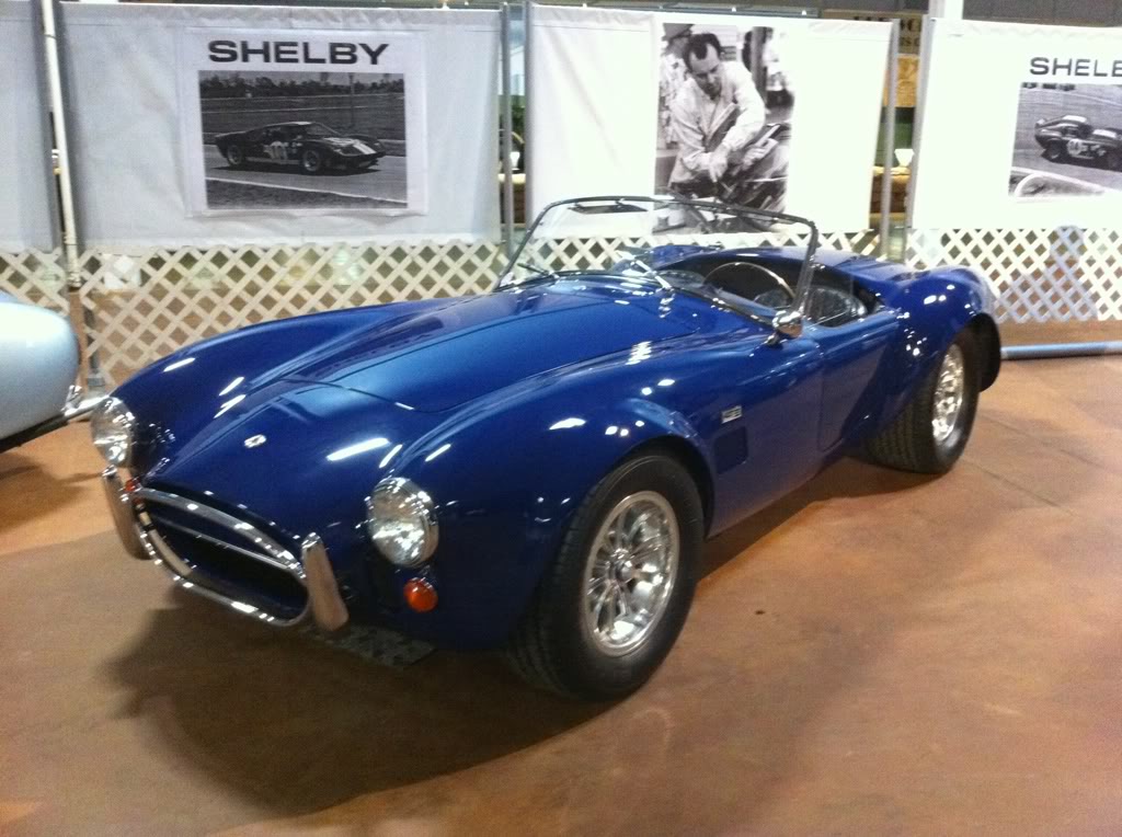

Hi all. This pic was posted some time back of a CSX? at the Simeone Museum:
Can anyone speculate what the finish is on the Sunburst wheels. They really POP!
My wheels have been lightly sandblasted and are a dull grey:
I would love that bright finish.
Is it a different blast media? Some sort of processed finish (Diamond Brite), or were they polished?
Anyone know this car and it's owner so I can ask?
Greg
11-06-2013, 02:58 PM
Join Date: Sep 2000
Location: Holderness, NH, US of A,
NH
Posts: 5,499
Steve's car, wheels have been polished.

Thanks Nick. You've always got the info.
Complicated wheels and quite a rough cast finish. Must have cost a fortune to polish!
Greg

It really isn't as bad as it looks. I would guess about $250 each to have those polished. I had some hurricane style wheels polished a while back. The guy had them blasted with some type of media, then started with 240 grit and worked his way down. I paid $200 each a few years ago.

Sandblasting will murder the finish on aluminum as evidenced above. Bead blasting will leave them brighter. When I bought my wheels it was $100 a wheel to have them polished.

I know I'm the oddball here but I like the look of the sand blasted wheels. They have a more vintage look that I like. Just my opinion though.
