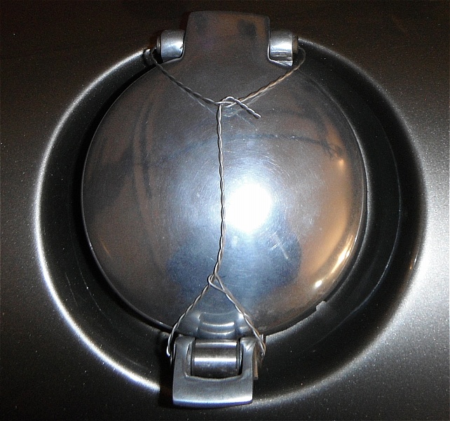

A couple of years ago, Jamo posted a great pic on how he wired his cap to discourage "monkeyers," but still be able to quickly gas up (because the ends just pull out). I've had it on my to-do list ever since, even though it's a quick job. Yes Chas, now when I'm wolfing down that thermidor, I'll rest easy knowing my fuel-filler cap is protected. And you gotta admit, it looks cool, too.

You'll get tired of that at fill-up time. Jamo's was one continuous loop around the hinge and snugly twisted at the clasp. Barely enough slack to lift it off the hinge side. I only did that on-track.
Scratches your aluminum if it's working correctly. A tab of electrical tape prevents that.

Chas, you do realize that the sole purpose is to give the appearance that it is securely wired down, but to be instantly removable for fill-ups, and then quickly re-fastened.
No Sheldon-the sole purpose of this is to prevent a gasoline bath in an on-track (or street) rollover.
That is - for real users, not posers.
A 5 year-old could still tamper with what you've got and pee in your tank.
Incorrectumundo, exhaust breath. The sealing cap beneath the flip top handles that quite nicely. If I roll over hard enough to rip the flip top off, and the cap beneath it, then no piece of safety wire is going to save my sorry ass. You just hate it when I win. BTW, that twisted wire is quite firm, and you would never be able to tell that it's ornamental. And it "hinges" open without touching the fender, so there's no danger of me nicking that beautiful paint job, either.

I have 42 gal fuel cell with bladder and flip over baffle. I use same wire as on knockoffs and use piece of clear fuel line slipped over wire just before final twist to keep from scratching aluminum cap. Use fuel line around spoke when putting wire to knockoff also.

We have found small ID clear model aircraft fuel line to work very well with safety wire. Stays clear and is very flexible not mention cheap! Soft enough not to mar the aluminum.
