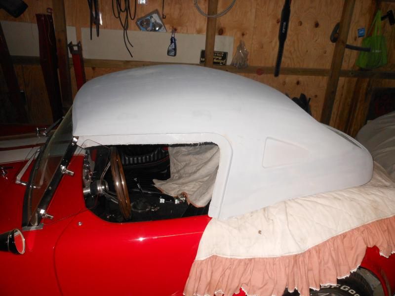

I got my top this week from Mr Bruce, and it looks top notch.
His crate building skill were also top notch at the top was fully braced in every direction.
I will have to do some work to get it to fit as Mr B told me in advance, but I'm just glad to have it.
I think at some point I will cut the back of the top, and have it where I can open the rear window, and the trunk.
Sorry for the bad picture, but my battery is either disconnected or ran down so I can't get the car outside just now for better pictures.

Very nice! Can't wait to see it fitted & painted

Looks like I may have to chop my roll bar just a bit to get the top low enough to look right.
Anyone have any experience with lowering the roll bar? I have some pretty good fabrication skills, but it would be nice to have a heads up on anything note worthy.

Here are a bunch of pictures of mine for your reference:
FIA HardTop Photos by Fullchat289 | Photobucket
Hopefully there is some adjustment in the angle of your windscreen and you can bring the back of the window opening consistant with the door opening. Have fun with the project!

Thanks for that tip, as it was spot on. I just went, and removed the bottom bolts from the windshield, and pulled it back about a couple of inches, and now it fits right at the rear door parting line.
Oh, and thanks also for the photos. I hope you don't mind a few PMs if I get stuck........
It's reasonably straightforward, but can be tricky depending on a few things (such as access) and may be a bit more work than it initally looks like.
Basically unbolt and remove everything, measure and cut off however much you want from the hoop and down bar.
You will likely have to cut off and re-weld the mount for the down bar because the angle will change, and will likely need to enlarge the hole in the body so you may need to glass in the extra area in the hole that is leftover from the old opening. So that area may need new paint.
You get the idea.

You are welcome to shoot me pm's or emails...glad the windscreen angle suggestion was helpful. Looks like Bruce left you lots of material on the bottom edge to get the contour shape of your body....I know you've got the roll bar to trim, but have a look at my pics, or Google "cobra lemans hardtop" for images to give you a guide for how much to cut off..

Once you get it fitted and painted that is going to be a nice top. One question about the roll bar. If you lower it, will it be lower than your head when you are sitting in the seat? Here if a cop is in a bad mood they can and have ticked dome people for that.
The roll bar is a good bit over my head, and I am around 6 ft tall.
I think most Cobra kit car makers do this to accommodate as many different size people as they can.
I figure to measure it to just about an inch, or so above my head.
I'm glad Mr. B left lots to cut as its easier to cut the excess than to add.
