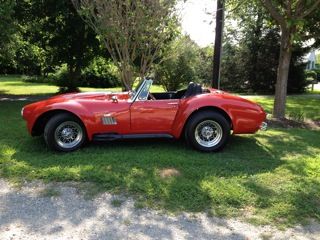

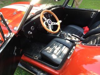

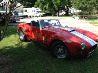

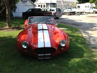

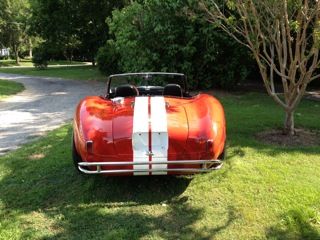

Here are some pics.

Old 07-04-2016, 03:33 PM
Buzz's Avatar
Posts: 3,786
Originally Posted by John S View Post
Here are some pics.
Hi John - can you tell us more about the car? From the pictures it looks like a rebody of some sort - possibly an MGB?
Definitely not a Cobra in the sense that most of us are used to with a twin tube chassis and a fibergalss or aluminium body, so much of our experience with seats, etc. may not be applicable. What drivetrain does it have. And lastly - have you already bought it?

Originally Posted by Bill E View Post
We do custom seats to fit you and your car.
Did you think resurrecting a 1.5+ year old thread where the OP has not been logged into the site since 10-05-2014 06:19 PM was a smart idea
Modified MG Midget chassis.

The car could be a Tomahawk 280 Z based

Old 07-05-2016, 06:08 AM
MOTORHEAD's Avatar
Join Date: Feb 2001
Location: BRADENTON, FL
Cobra Make, Engine: KIRKHAM 427 S/C, SHELBY 427 ALUM. STROKER
Posts: 1,396
That's definetly an MG center section, w/s, door panels, dash, seats,etc. made by C-F enterprises of L.B. Ca. Basically used MGB platform with their front and rear body panels.
