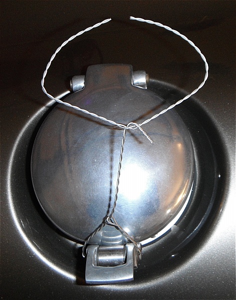

A couple of years ago, Jamo posted a great pic on how he wired his cap to discourage "monkeyers," but still be able to quickly gas up (because the ends just pull out). I've had it on my to-do list ever since, even though it's a quick job. Yes Chas, now when I'm wolfing down that thermidor, I'll rest easy knowing my fuel-filler cap is protected. And you gotta admit, it looks cool, too.

You'll get tired of that at fill-up time. Jamo's was one continuous loop around the hinge and snugly twisted at the clasp. Barely enough slack to lift it off the hinge side. I only did that on-track.
Scratches your aluminum if it's working correctly. A tab of electrical tape prevents that.

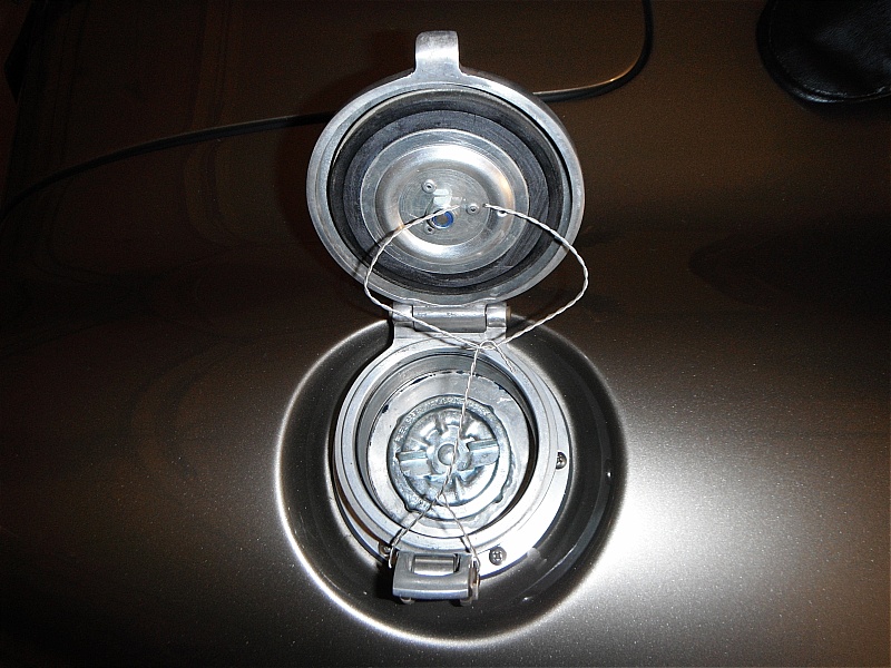

Do ERA's have a locking cap inside of the flip cap?
Chas, you do realize that the sole purpose is to give the appearance that it is securely wired down, but to be instantly removable for fill-ups, and then quickly re-fastened.

There's another, traditional gas cap, under the flip-top. I don't know if there's enough room to replace it with a locking one or not, though.

Stant 10582, as recommended in the ERA manual. You can get it on Amazon.

I did mine ala Jamo and I dig it.
No Sheldon-the sole purpose of this is to prevent a gasoline bath in an on-track (or street) rollover.
That is - for real users, not posers.
A 5 year-old could still tamper with what you've got and pee in your tank.
Thanks Jamo, glad you reposted.
Chas.
Old 03-02-2014, 08:41 AM
Posts: 22,025
Incorrectumundo, exhaust breath. The sealing cap beneath the flip top handles that quite nicely. If I roll over hard enough to rip the flip top off, and the cap beneath it, then no piece of safety wire is going to save my sorry ass. You just hate it when I win. BTW, that twisted wire is quite firm, and you would never be able to tell that it's ornamental. And it "hinges" open without touching the fender, so there's no danger of me nicking that beautiful paint job, either.

I use the Stant 10582 locking gas cap.
It seems to fit well, just aim the 'fixed ears' at the slots in the filler neck rim and the 'spring ears' click as they latch under the rim of the filler neck when pushed straight on.
That being said, it's hard to get a hand in there at the same time, so I lower the cap using the key, then push it in to click. Removal of the gas cap with the help of the key is also no problem, but once the cap is out from the filler neck area, keep a hand on it so you don't risk dropping in on the fender ...
