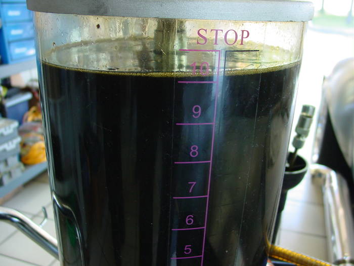

Thought we show you guy's how we do the maintenance on KMP259. Like changing the oil in a car with a belly pan.
We evacuate the Dry Sump Tank and measure the oil that came out as well as inspect the oil for particles as well as color. Usually it's quite Clean ... but you never know.
BTW this is the way we change oil in Mercedes, Audi, and BMW..... all of the German cars that have belly pans need to be evacuated this way. much easier and faster and more complete. The evacuator will suck down to the floor of the pan.... as opposed to when you drain a pan there is about 1/4" of oil left in the bottom of the pan.
And you can see exactly how much oil came out each time....
Morris

Here the oil is 200*degrees coming out, so it doesn't matter how hot it is we suck it out and then take a Sample and send it to Blackstone for analysis.
I must say you have to be very careful as these cars are very hot when they come off of a Track or just off a Street test. But this makes changing fluids simple ..... we use a filter on the pressure side and another filter on the scavenge side before it goes to the Dry Sump Tank.

Apologies for the stupid question... humbly, what's the real advantage of knowing how much came out?
Is it tell you how much you consumed? or how much you need to put back in?
Dimis
When you evacuate the oil in a container you will inspect the oil for contaminants like Water,......intake manifold leak...... also how much you get out verses how much you put in, is it in the catch cans or on the ground....... The cloudiness of the oil for aeration of the oil..are we creating air in the system........and in general get a good sample from the tank to send to the Analysis.
