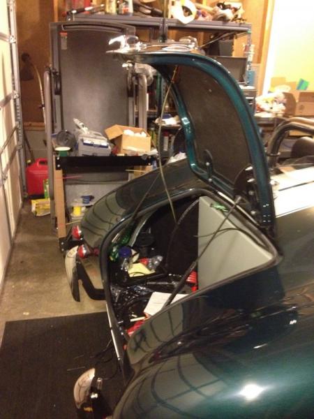

I have been thinking about it. I did it for my hood and it worked out great! I'm going to try to hide mine so the shocks will not be visible.

Take a look at the lid mounted bracket. The shape allows the strut to apply no upward pressure to the fiberglass lid.
Neat installation - just remember gas struts should always be installed with the main body on the top side and not like you installed them - unless those are special struts??
See here:

Larry - I like what you did.
I have like over 10 years of "road" and have been looking at Spats.
Nice job on the Cruise Control and gas struts.
