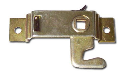

I have a Mr. Bruce 289 FIA body with his fiberglass trunk,pan on a modified FFR frame. I have the trunk,latch installed in the trunk, but no "latch pin" on which the trunk latch can grip to keep the trunk closed. Any ideas? Original design?

This is what your trunk uses for a latch?

Yes, my latch looks like that. But my latch is located too high. I'll have to make something special.

I discovered another issue (endless it seems) this time with the trunk latch arm. As it moves from locked to unlocked, the arm hits the body. Looks like I'll have to notch it like in the picture above. I've marked the body where it needs trimming back (black line) and where the hole needs to be made to allow the arm to clear (orange line)
