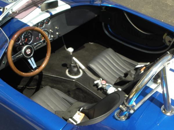

Here's a picture of my shifter: the hat - Club Cobra Photo Gallery
The original 427s that Shelby put automatics in had this shifter - it's a contemporary Mustang unit from around '64-'66 I think - it has been a while. It does have the original appearance and is hooked to a C6, same as the originals. It is intended for a 3-speed auto and would work as is with a small block C6 or C4. Perhaps it could be used with an AOD but might need some tweaks?
As to cooling, I use mine on road courses and it is definitely needed there. Drag racing, I don't know - I would guess it depends on the number of runs you make and how soon after each one the next one happens. If you did one every 10-30 seconds like the road courses require, you'd definitely need a cooler. If there's a half hour or so between runs, probably a cooler isn't needed. After incinerating three transmissions I tend to think a cooler is necessary even for spirited street use. Most street vehicles come with some kind of cooler built into the radiator tank at the least. Owners add them if the vehicle is used for towing and doesn't come with a tow package. They are relatively cheap especially when compared with renewing the trans and converter.
As far as shifting, I put mine in D and go racing. It doesn't upset the car if it downshifts under power - something that seldom occurs. If I'm exiting a really slow corner, the downshift happens at part throttle so it doesn't try to break the rear tires loose. With lots of HP, one gets an education quickly about the meaning of the term "roll on the throttle." If you stomp it you'd need to take a compass reading first so you might have some idea where the snap spin is taking you...
The trans builder can probably take care of the downshift behavior. In drag racing, get a trans brake and see how far you can carry the front tires when you stomp it
As far as the upshift behavior is concerned, mine (and likely most others) behaves like a street car: The upshift speed can vary with throttle position, so if you accelerate gently it will upshift at low speeds. As you increase throttle and load, the upshifts move to higher speeds.
Some of the shift point behavior is adjustable with the "kickdown" lever and linkage found on the C4/C6 - the AOD can be adjusted too I think but I have forgotten how. Sorry. I dimly recall a TV (throttle valve) rod for the earlier all-mechanical version of the AOD - the caveat there was that if you adjusted it incorrectly you were likely privileged to buy another trans.

Tom, thanks for the photo. It appears to be located in the same position as the T5 shifter. You have a very nice looking car. I'll check into a trans brake and I think I'll go with a cooling system on the front of my vehicle(where the oil cooler would fit). Also, I'll check into another radiator with a tranny fluid cooler incorporated into it. Thank you for the information. I'll be checking into all of this starting Monday morning.

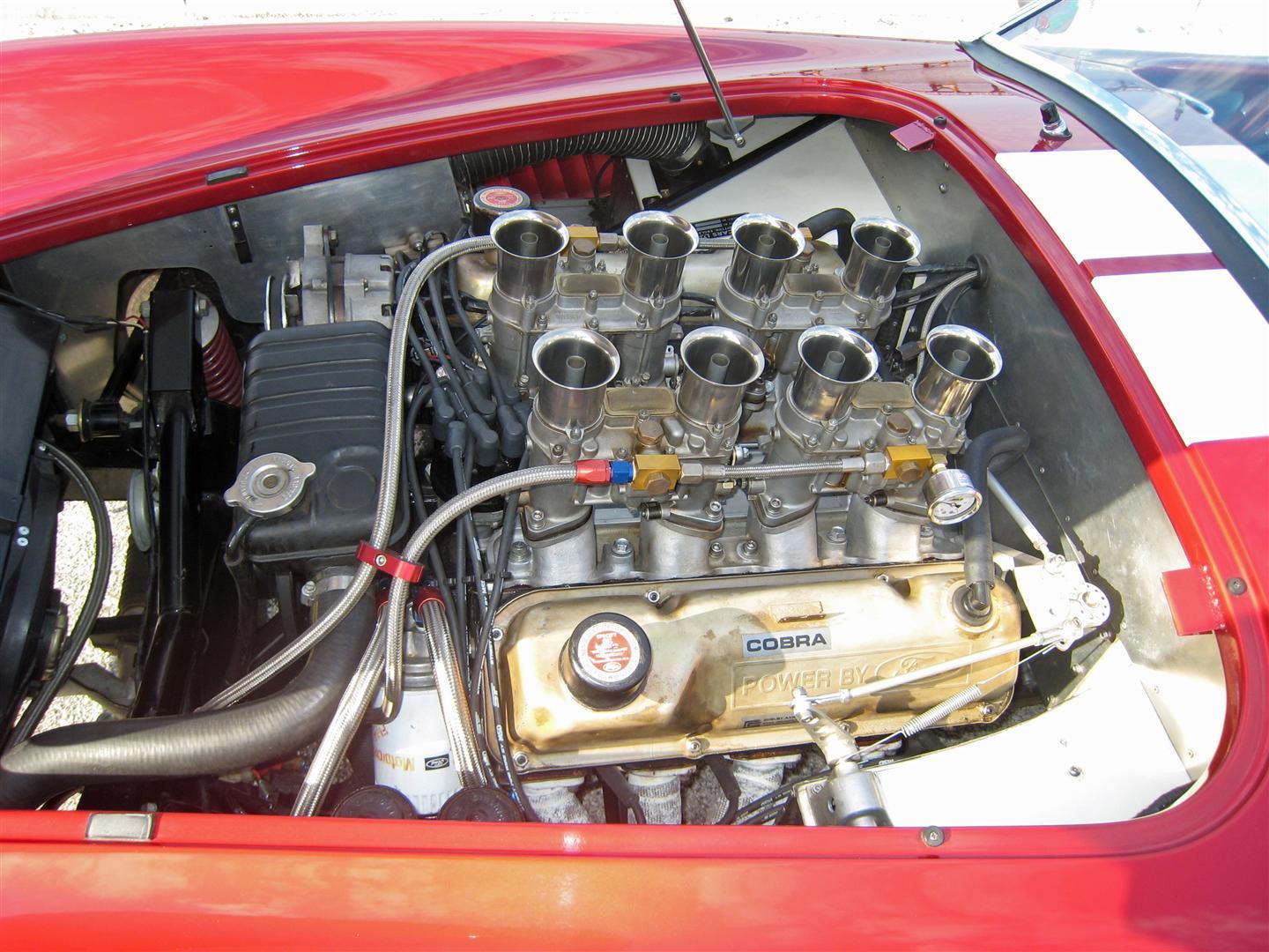

You might not expect to find a built C4 automatic under this shifter.....
However, having a bum leg has forced me to have to have to convert a number of my cars (including my HiPo Mustang, BOSS 351, and ERA 289 FIA) to automatic trannys. I've had very good results with a C4 (I used a small-block C6 in the BOSS 351, and had an AOD built for my ERA that I never got around to installing).
I shift my C4 with a 289 Cobra shifter grafted to a standard C4 shifter....
The rusty looking part is where they are welded together (with the boot installed, it doesn't show). The original lockout mechanism is functional. I had the two shifters welded together with an angle to the left, so that when the shifter was in "Park" position, it would look like a 4-speed parked in "Reverse". I have no shift indicator, I shift it by feel only.
I believe your best bet is a built C4. The C6 small-block is big and heavy, and uses up a lot more horsepower to operate. The AOD or AODE is big (an inch longer than a C4 and a good bit bulkier), heavy, and may require the addition of electronic controls.
After experimenting with a number of different setups, I finally have my C4 shifting exactly like I wanted it to, which is the firmest, hardest, tire-screeching shift into each gear. Along the way, I tried a full-manual reverse-pattern valve-body, a fully automatic valve body, a semi-automatic valve body, and eventually the one I have now which is a forward-pattern full manual valve body. My preference leaned toward full manual due to the complications of plumbing vacuum lines to the Webers for the automatic shifts.
I bought my stall converter and full-manual control valve body from Broader Performance Broader Performance in Texas. Your desire is a bit different from mine, as you want to be able to shift automatically in Drive, and override manually when you want to. For that type of functionality, I have had very good luck with using shift kits from Trans-Go TransGo-Home Page. Their kit will allow full automatic operation with manual override whenever you want it. With that kit, you do not get automatic downshifts, as you eliminate the downshift control cable, which also prevents "surprise" downshifts in a corner.
I have run these C4s in open track and autocross events with good results. Maybe not quite as exciting as rowing the gears of Top-Loader, but, they will get the job done.

Era 351 fia
Landmass -
Clicking the photo icon beneath my profile picture should take you to a bunch of pictures of my car, engine compartment, and build.
