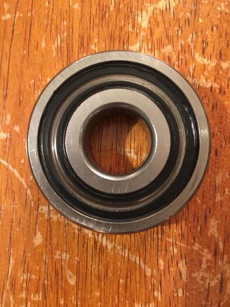

Well I had one of those funky sealed bearings on there so I thought I'd replace it with the same since it worked fine.
Did I read somewhere that Tremec's called for the bearing style rather than the bushing? It's a McLeod clutch if that makes any difference.

dcdoug 09-02-2017 03:33 PM
Some wear, but maybe I'll just put the one I've got back in.

patrickt 09-02-2017 03:38 PM
Nope, now that you've touched it with your fingers it's contaminated and will have a shorter life -- just like the 500w tube halogen bulbs that go in my garage trouble lights. If you touch them, they die.:cool: Go with a new bushing.
Gaz64 09-02-2017 04:20 PM
I wouldn't reuse a ballbearing pilot bearing.
Even if you knocked it out by the outer race, it's not worth the risk for a $10 bearing.
A sintered bush can be soaked with oil with the pressure from your thumb and index finger until you see the oil weeping through the porosity of the bush.

The rule of thumb with bearings or bushings is that it depends on the clutch disc material, not the transmission. An organic disc is very easy on bronze, but a disc that has a sintered material on one side can have dust that will contaminate and wear bronze, so it's best to use a bearing in those cases.
dcdoug 09-02-2017 06:03 PM
Mine is a McLeod 500 series disc part #260571 (organic/ceramic material).
blykins 09-02-2017 06:04 PM
A bushing would be ok with that disc.
