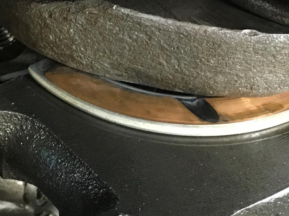

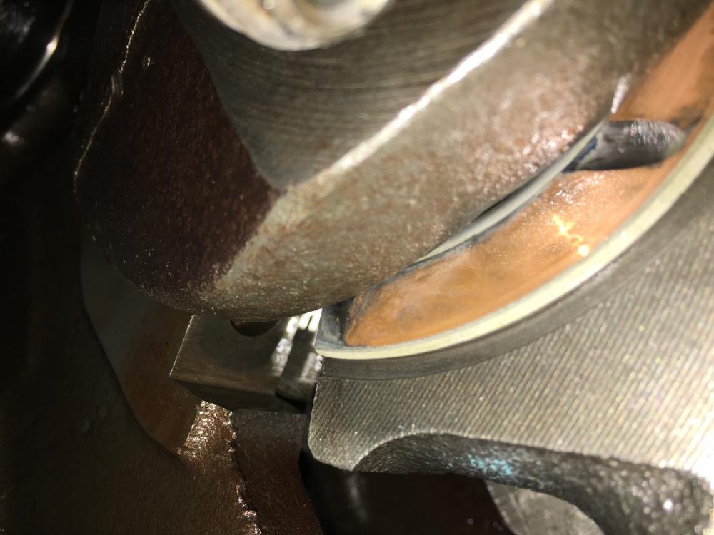

dcdoug 06-04-2017 04:14 PM
The oil pan scraper blocks removal of the main caps, but there is as much as I could show of #3. Any thoughts? I think the engine's got to come out at this point or I just won't feel good about driving it hard.
http://www.clubcobra.com/forums/pict...ictureid=16648
http://www.clubcobra.com/forums/pict...ictureid=16647
http://www.clubcobra.com/forums/pict...ictureid=16646
http://www.clubcobra.com/forums/pict...ictureid=16645
blykins 06-04-2017 04:20 PM
I don't see anything blatantly obvious.
Did you check crank thrust clearance? Very easy with the pan off.
I'm still in favor of buttoning it back up, changing the filter and oil, and putting a few miles on it.
dcdoug 06-04-2017 05:09 PM
How would I check crank trust clearance? The pan hasn't been removed, just the bottom panel has been removed. So depending on where I need to check it, I might or might not have access.
blykins 06-04-2017 05:23 PM
Bolt the cap back on, torque all the bolts, put a dial indicator on the crank snout, pulley, whatever is easiest, then take a screwdriver and pry in between a crank counterweight and the block, back and forth.
By the way, when the cap goes back on and the bolts are run down, pry forward on the crank while you torque the bolts. That helps set the cap and thrust bearing.
Snake2998 06-04-2017 11:52 PM
I know that if it was mine it would be out - much cheaper than replacing the whole engine - I would tense up every time I took it over 3000 RPM.
dcdoug 06-05-2017 08:56 AM
I don't think I'm going to enjoy driving it nearly as much if I'm constantly worried about the engine. I'm gonna pull it and have someone better than me figure out what that metal's from.
I appreciate everyone's help and suggestions and will report back when I find out what the issue was. It will probably be a month or so.

Karl Bebout 06-05-2017 01:21 PM
DCDOUG, I'm thinking you are doing the right thing. No doubt you've got a whole lot invested in your SO and don't want to have it become nothing more than a boat anchor.

Gaz64 06-05-2017 08:40 PM
I think I would start looking at any bearings directly above the trap door area of the sump.
Wiggle the rods, one might be obvious.
dcdoug 06-06-2017 07:00 AM
They will all be inspected.

Gaz64 06-07-2017 04:15 PM
I'm curious as to what the dings on the crankshaft are?
