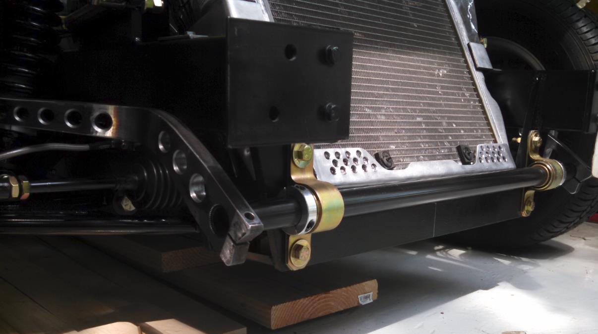

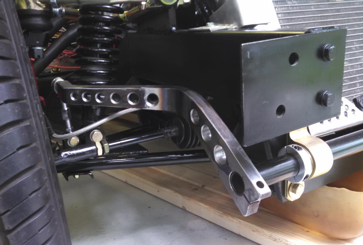

Old 01-11-2018, 07:25 PM
Join Date: Mar 2013
Location: West Haven, CT
Cobra Make, Engine: Lone Star, Ford 302W
Posts: 23
Speedway Eng. Sway Bar and (modified) Arms, mounted in a Lone Star
Old 01-12-2018, 02:51 PM
Join Date: Aug 2010
Cobra Make, Engine: Lone Star with IRS, 427W with megasquirt, T56 magnum
Posts: 309
Nicely done, Frank.
FrankR105 likes this.
