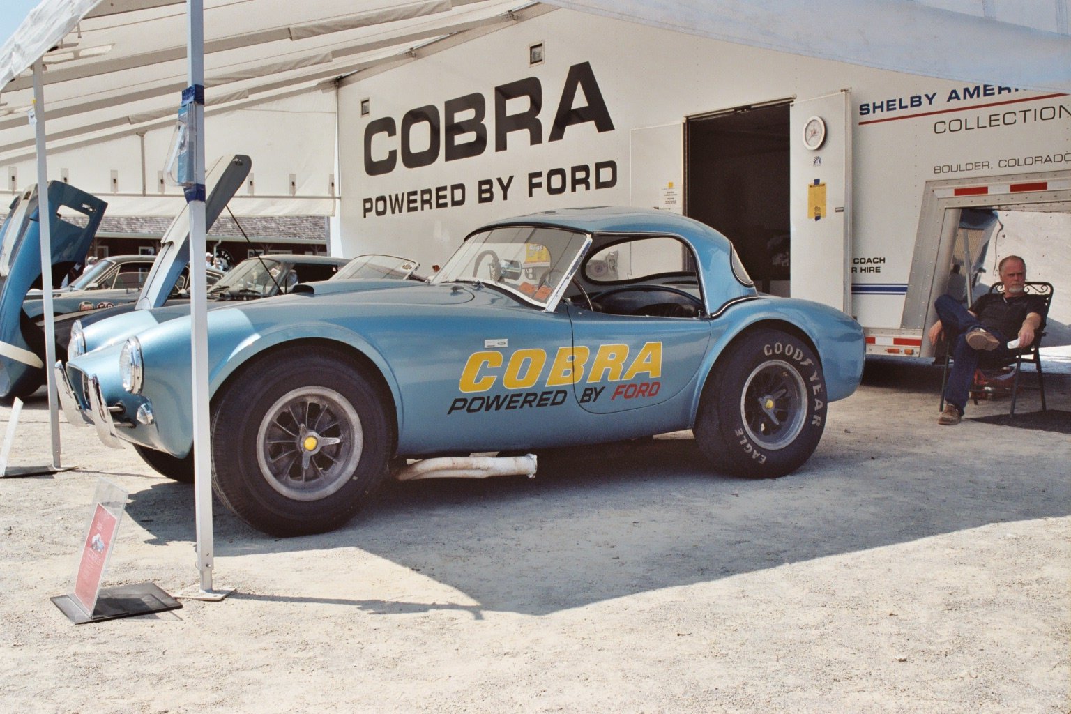

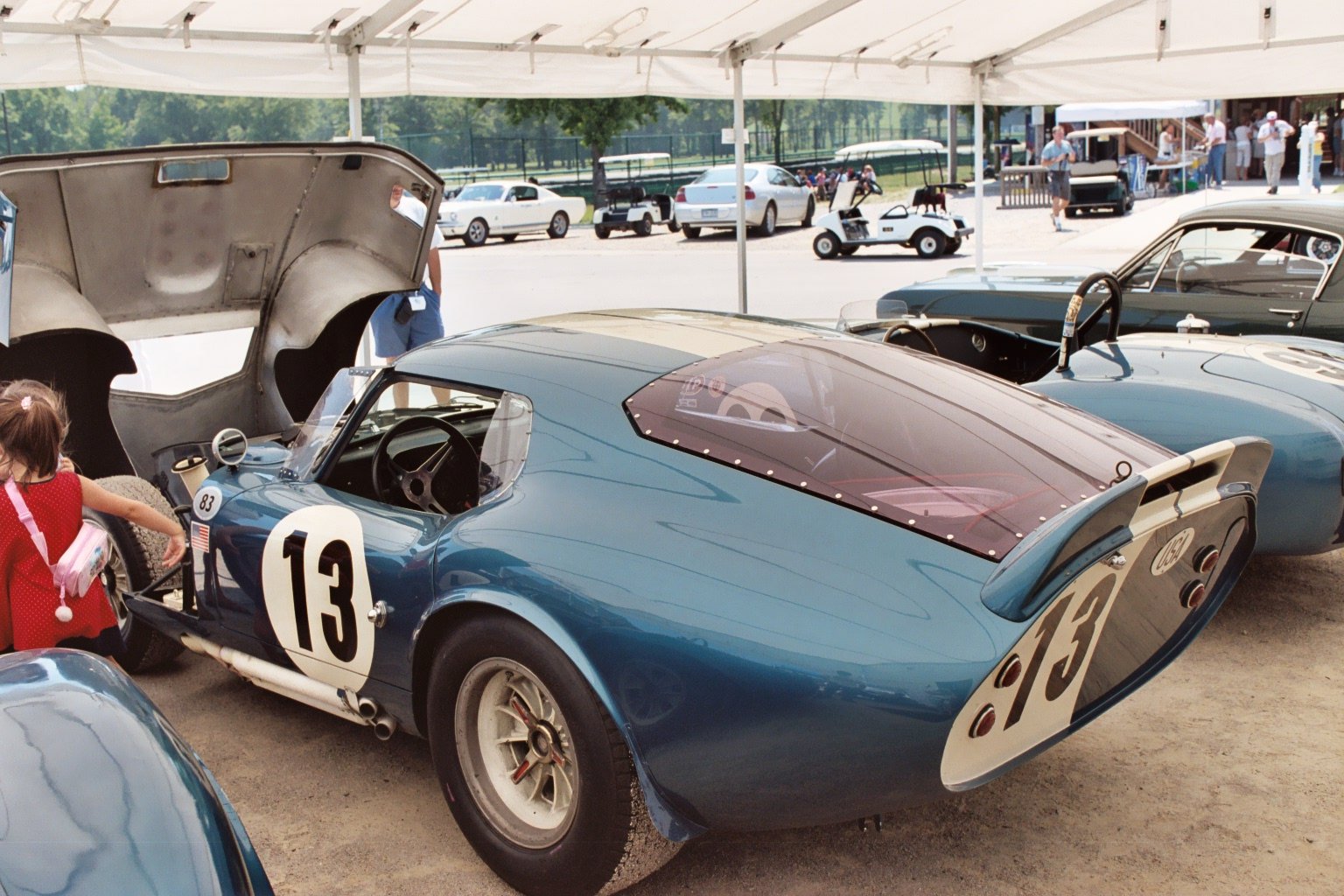

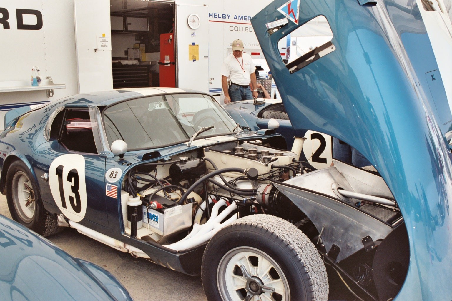

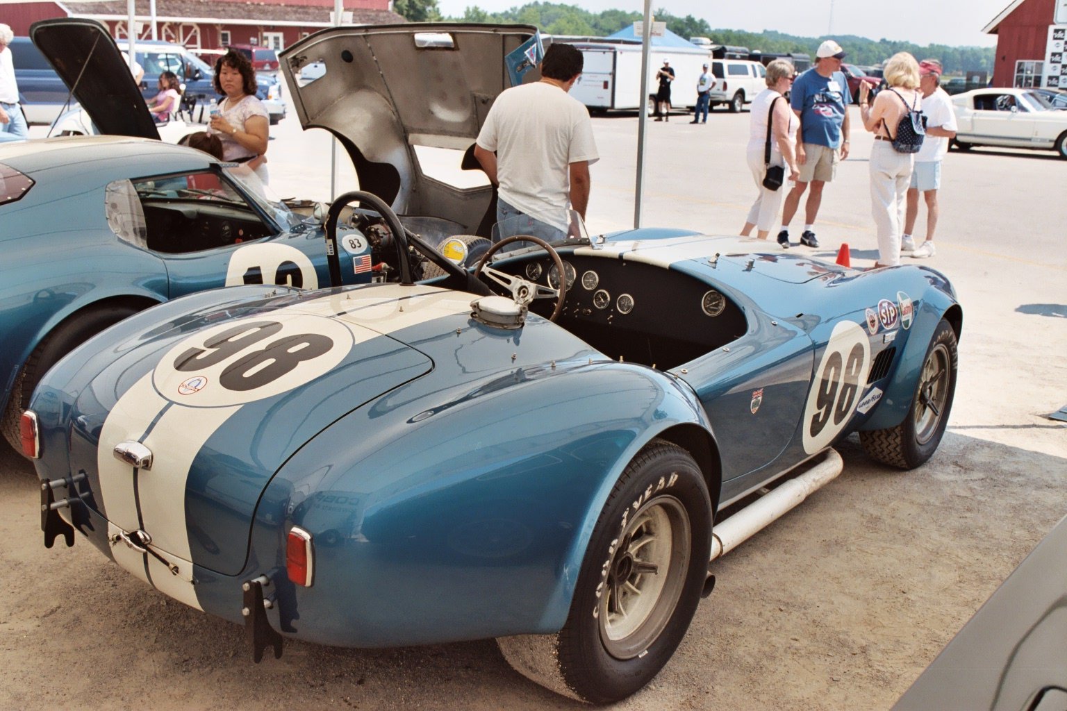

Well it looks like it was common on original 289 competition cars. Here's some pictures I took at SAAC 31.
1985 CCX likes this.
