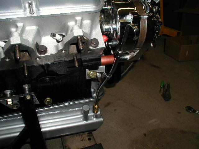

Joe A,
Here's a detail shot of my setup. Note bracket made to secure to block. Also, that cap on the bigger "stem" is $18 from Gessford.
Joe

SPF1609
Nice mounting for the dip stick. We usually just bolt the dipstick to the water pump.
We use the tube that you have covered up with the cap for the oil drain return line from the oil vapor seperation tank on the firewall.
David
