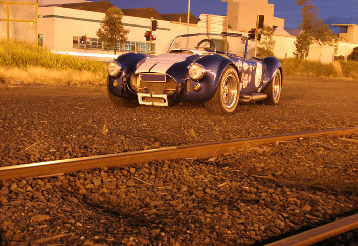

PJ10
No problem.
The wheels are manufactured locally here. They are not pin drive though..
I have spinners that are missing in the following photo. I wire them back to the wheels when on.
This is an older photo taken when Aussie Mike - Mike Murphy - put the new side pipes on at his house, just after he made for me. You get a better idea of the wheels here.
Bernie Knight

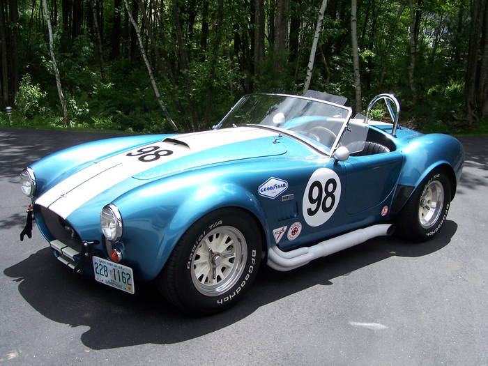

Powershift1038
I have the decal/sticker gumballs on the doors with the decals/stickers on the guards/fenders.
The front and rear gumballs are painted on as are the yellow Team/Rookie stripes.
Bernie Knight
