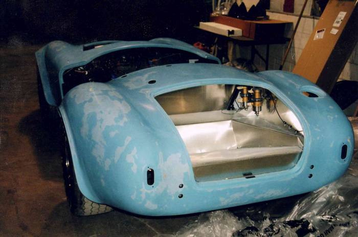

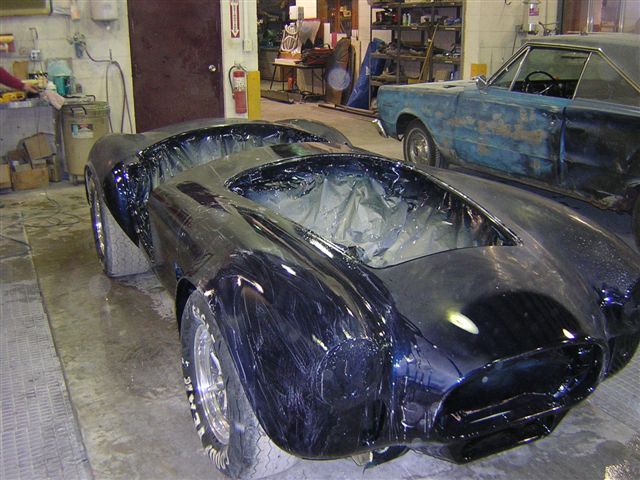

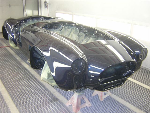

Yep a good paint job will cost you about $8 grand. Also, to do it right you will have to strip the car down, paint it, and build it back up.
Here are some pictures from my Kirkham paint process. More in my gallery.
