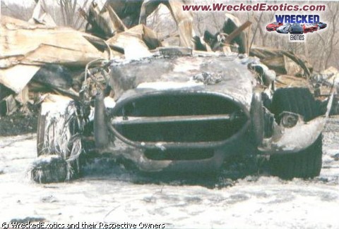

So you don't wanna buy a fire system?
Glass cars burn fast......
Roscoe

I have one nozzle in the engine compartment and one in each footbox (per Safecrafts suggestion.) The ones in the footbox blow down toward your feet so you get the blast bouncing off the floor and back at you.
Basically the fire system allows you to get out of the car uninjured. If the fire goes out that's a plus.
Get good insurance too.
Roscoe

Man! that is one sad picture....Thanks fellas, I needed a kick in the a$$ to do it right.............
Perry

Alloy cars don't like fire either. Here's CSX 3117.....
Sal Mennella
