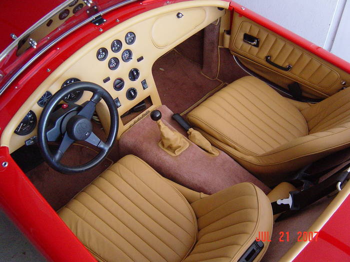

Joshc
I did go for originality.
However, firstly I feel that you need to sit in your car and design your dash based on what is easily visible to you as the driver.
If you are on the track consider a shift light - stops you getting carried away. Mine is next to the steering column and hits my eye easily once I hit the rev zone.
I personally do not like gauges sitting up on dash tops, or worse still outside on hood/bonnet tops - this is a street machine thing or high performance racing. Just my opinion.
...just keep browsing the galleries, you will see some different layouts. I have seen different wood, vinyl, late model car dashes on the galleries here..... Just as HighPlains Drifter has suggested.
Just my $0.02 worths

Bernie,
I like your setup, except I would prefer the steering wheel on the other side. LOL. I would like to put most of the guages in the area just above the trans tunnel and maybe mount them at an angle towards the driver but leave the tach and speedo up high. I am also planning a push start button. Thanks for the replies.

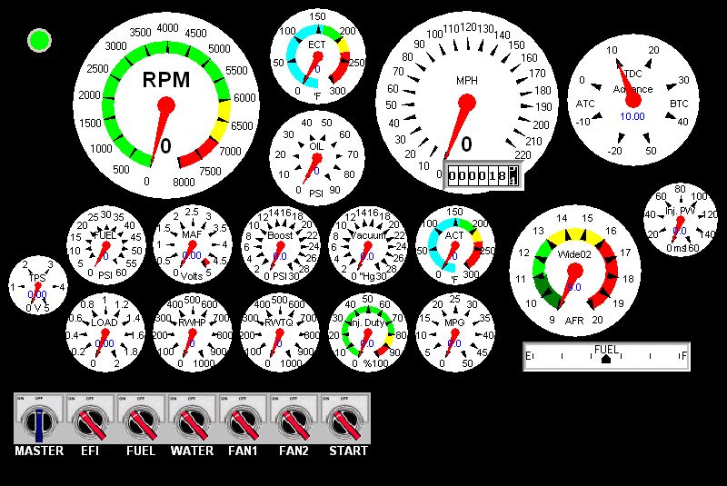

Default My dash...
Originality isn't for everyone. It's not a real cobra and never will be...so I'm doing it my way.
My dash consists of a "Rock Me" button from a Fred Flintstone Pinball Machine, a hat switch for "on", and a 12.1" military touch-screen display/control system I home brewed based on my SnEEC datalogger product.
Yeah, it's busy, I like it. If you want it less busy, touch the drag race mode button and all you have is a giant tach and warning lights. The software, gauges, controls, all that are just software; I can change it at will. Everything is controlled by a custom power control board and a little on-board nano PC.
Here's a picture of the dash:
http://www.racesystems.com/cobra/images/dashscreen.jpg
If you want to see what the rest of the bits look like, there's pictures on my site here:
The best part is, you drive down the road with all that stuff displayed...it logs every second that the engine is running to a file with the day, date, and time on it, and if you're in a public wifi area, it uploads the logs home. And, of course, if you want to check your email, watch a movie, do GPS navigation, play your mp3 files, or whatever...that's just a few taps of the screen away...it's a full PC.
Byron

I like gadgets SWEEEEEEEEEET

Default Since someone is going to bring up "what if"...
If the PC goes haywire, no big deal. You just unplug the cable that goes to the PC, plug it into a manual override box, and you have discrete control of all the circuits. It takes a little more to hotwire the car than the override box (intentionally), the EFI won't work unless you know how to enable it.
I don't let the PC control critical functions that could stall the car while in operation or create a hazard condition like no headlights for example. Things like fuel pump power, EFI power, headlights etc are either powered by the manual power switch or under hardware control (they latch on until main power has been removed). The PC can go completely haywire and the worst thing that happens is you lose the dash display and the ability to restart the car (once you manually power it off). To limp home, you need to perform a manual override, and essentially hotwire the EFI. I'm the only one that drives the car and I could get it into limp home mode within a minute or two...no big deal.
It's as safe as a cobra gets.

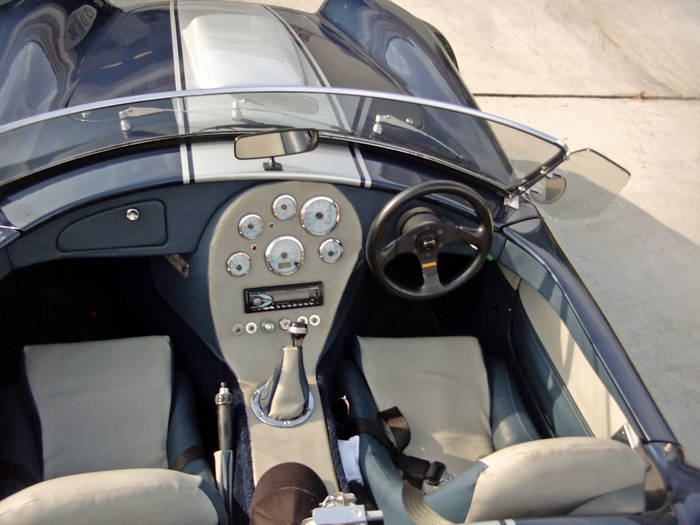

How about AKL style?
