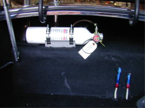

Not hijack the thread, but where do you mount the bottle?
Old 01-14-2008, 11:30 AM
Roscoe's Avatar
Join Date: Mar 2000
Posts: 5,900
I mounted mine in the trunk.
Roscoe

No a Cobra, but on my 65 Mustang Coupe road race car I mounted one outlet on the firewall facing the back of the carb, one under the dash pointed at my feet and the last one is pointed at the fuel cell.........
BTW: I have the same bottle that Roscoe has pictured.........I like their set-up.......
