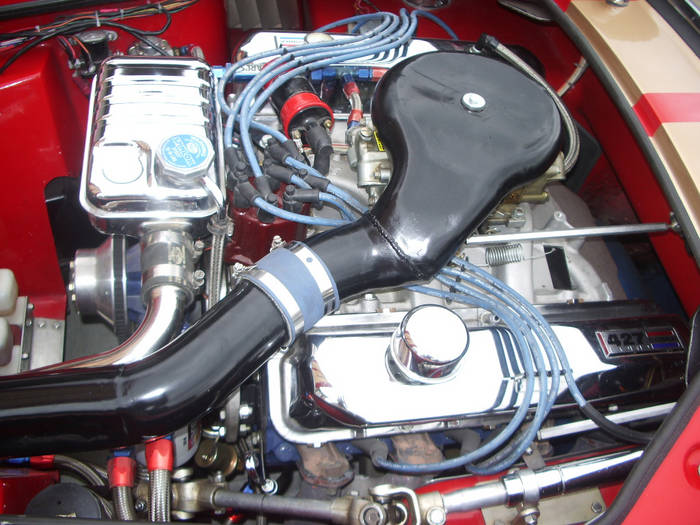

I took the original cobra air cleaner for Ford Motor Sports and a Edelbrock 14" drop base cleaner and mated them togther. I went for the 3" K&N filter (E-1963) that is the replacement for the stock 1.75" filter element.

This is a air cleaner that the guy who had the car before me had built...doesnt show but it goes out to the front with a K and N filter on it ...not sure how it will work thoughts?
still seems a little restricted to me.
