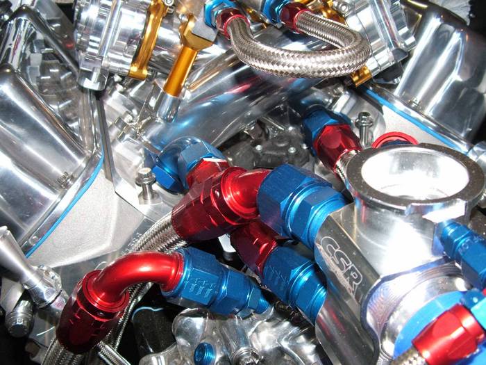

Heres my problem. Ive got a 3 piece intake manifold where water exits through 4 -12 fittings, 2 at the front and 2 at the rear. I have diverted one at the rear to the heater which then exits the heater and loops around to the top connection on the water pump.
I have blocked off the lower connection.
Do I have a problem?????

Mando, just so everyone's on the same page;
Is this your set-up?
Steve

Hi Steve, yep thats my nightmare.
Hi Jac Mac, at this stage I dont have a t/stat. Do I need to install one? If so where would you suggest it would need to be fitted? I have installed a T fitting into the rear LH -12 line to feed the heater, then I have a -12 line where water exits the heater that runs to the header tank at the front of the motor.
Does it matter if it doesnt return to the waterpump?

Mando, do you or Steve have another pic of your system from either side, I was going to draw a sketch of your reqd hose layout, but would like a better pic before doing so.
The two -12 lines you currently have from the rear of the intake are not reqd in my view.
Water for the heater should be sourced from the housing with rad cap.
No coolant should be removed from the rear of the intake or heads ( other than a couple of very small bleed lines in some cases to help bleed any entrapped air only-no major flow - these should plumb into the same point the front -12 lines do by the radiator cap)
Return from Heater must return to suction side of pump IE the lower barb on pump that you currently have blocked off.
Thermostat- do you need one, in order for the heater to function & have quick warmup periods,Yes. If this is a dedicated track/race car you can fit a restrictor in the top radiator hose, in which case the bypass can be deleted, but only if its an out & out race car. Plus that looks like an electronic injection setup & I would imagine that engine temp will have an input into the computer that runs it.
Jac Mac

Ive got some photos in my gallery that may show things a bit clearer.
Why is it a bad idea to have water exiting at the rear of the manifold at the same rate as at the front ?
What would be the differance if water to the heater comes from "the housing with rad cap" or the beginning of the line that feeds into that housing?

Mando, The majority of coolant flow in a Ford is In @ front of the cyl block, up thru the large transfer openings at the rear of block/heads, then forward thru cyl heads to Exit at front---- to provide a rear exit as you have there reduces the amount of coolant available to cool the cylinder heads.
By taking your heater feed from the 'New,yet to be fitted T/Stat housing or that Housing with rad cap' you will be taking an equal amount of coolant from both banks ensuring that flow remains even.

Mando,
While you could modify your current Radiator cap fitting, I would suggest you get somene to fabricate an assy similar to the one in the sketch attached and also purchase a header tank assy that can be remote mounted on the firewall. If you do this you will also be providing a source for your temp gauge /sensor fittings as well.
A Screw-On cap could be fitted on this assy @ top for initial fill purposes, but should not be necessary. As noted on the drawing the lower 5/8, -10 on the Header tank can be Tee'd into the heater return going back to the water pump.
Finally it would be wise to remove the 'goose-neck', in your Top Radiator hose by running it directly to the radiator to prevent the possibility of airlocks when filling.
