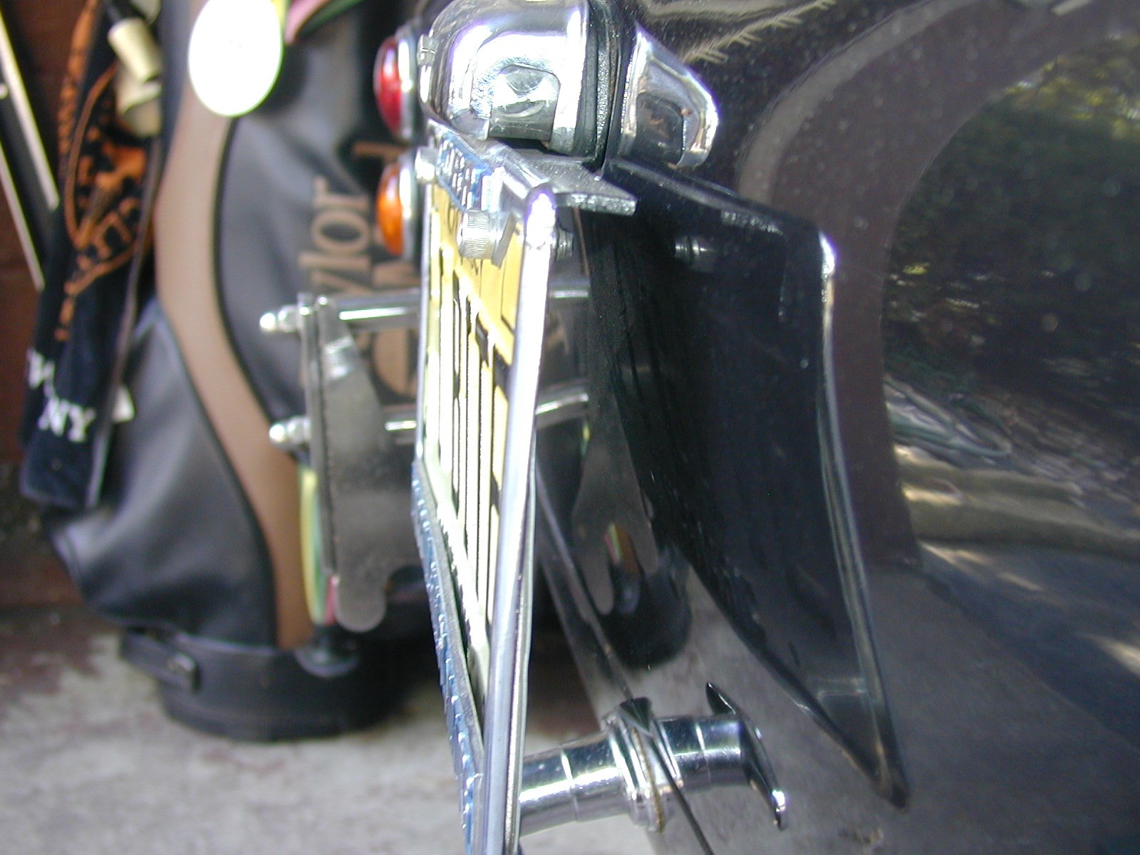

My rear license plate bracket broke off. By the time I got back to it (4 lane) the plate was beyond recognition. The holder itself broke, at the bend, just bellow the light.
My car is an A&C. I looked at a new one from Finish Line Inc. I couldn’t find any specs like bolt whole center. Would you expect it to fit? Do most of these accessories interchange from brand to brand?

I believe they are pretty much universal. I've never seen any measurements on the frames.... Finishline might tell you the measurement if you call and ask real nice

My Finishline one broke in the same place. I made my own out of angle stock.

I took Pgermonds advise and call Finishline. It will fit so I ordered the front and rear, as my car is missing the front and Ohio does require a front tag.
The origonal was aluminum. Maybe I should consider laying a bead of weld over bend areas and beef it up a bit.

Hey olddog, The FFR license plate brackets are noted for breaking. The fix : go to Home Depot, buy the smallest piece of straight stock alumunim, go home and measure the broken one, use a hack saw and cut the aluminum piece to the correct size. Measure and bend the piece, test fit, drill two holes of a larger size for the license plate bolts and two holes for the trunk mounting. Done.
