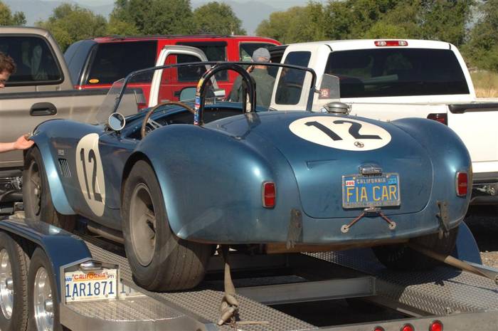

Ibr8k4vetts, Clois, Ron,
I couldn't agree more. I will post some of the most beautiful pictures of a Cobra I have ever seen--as soon as I can find the dang things.
Bob, I totally agree with your cost projections...though high end paint is moving past $15K now.
David

Posts: 6,990
Old 01-01-2009, 08:57 AM
David Kirkham's Avatar
Original Shelby Owner
Location: Provo, Ut
Posts: 6,990
This is an original FIA car. I think the sandblasted look is really, really, cool. I even leave it on my brushed car. It shows the car has been truly loved.
Old 01-01-2009, 09:28 AM
Location: Friant, ca
Posts: 106
its, its, perfect...
loved and driven what else could be better ?
brobehr
Old 01-01-2009, 10:23 AM
ICBomber90's Avatar
Location: East Greenbush, NY
Cobra Make, Engine: FFR Mark III, Carbed Explorer 302
Posts: 214
Dave,
That is the "look" I'm going for! Plus when one of my kids bounce a bike off it I won't
