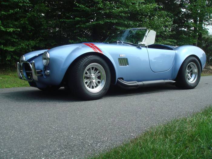

convincor- yours look nice and shinny, are they stainless ?
I just ordered a pair from "Firefly Performance Products" You have to check his out, their beautiful and a work of art.
yes, stainless. Mine are from Gas-N - http://www.gas-n.com/
But I changed the tips from the way they came.

they'll get a gold tint toward the front but thats it.
I'll re-polish once a season.
Here'a another shot. you can almost see the gold tint. -
