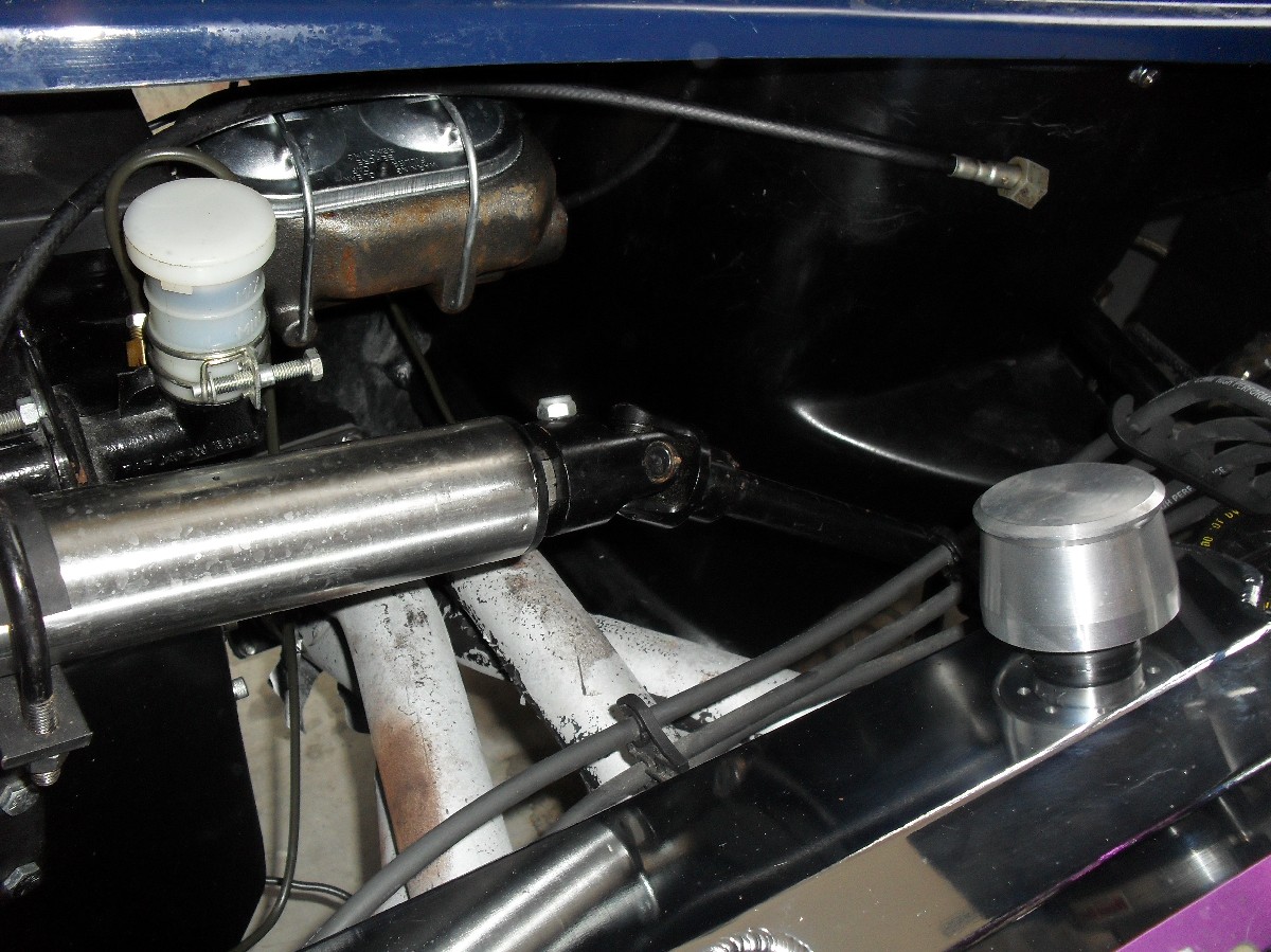

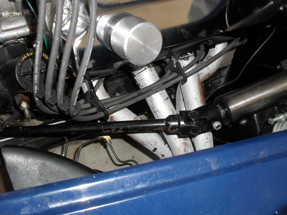

Another question, is the steering column. Does the steering rod and ujoint run under the driver side exhaust header? Seems a little tight there! Does anyone have a picture they could post?

The steering shaft runs above the headers. Its very tight, I have power steering.

Very tight indeed! Thanks for the picture, really appreciate it
