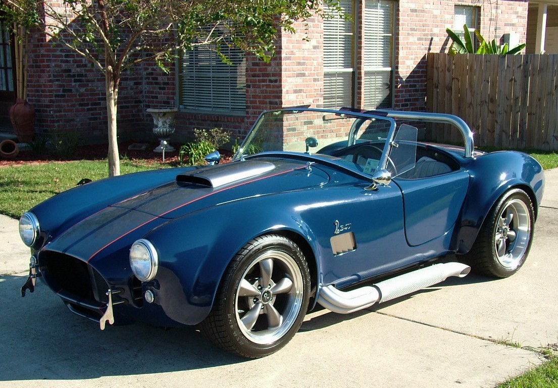

I agree totally with Jim. I'm very pleased with my choice. The body is great. I painted stripes on the gel coat and will paint the entire car later. You will see that the guys here will be more than glad to help whenever possible. That includes pictures if you need them, Just ask. I just have a general knowledge of machanics and I built my car completely with no problems, I did learn alot, like electrical. The manual was great for me.
My only question is, do you ever finish. I still want to do so many things. I changed my carpet to black this past weekend. I think I just miss the build process. That was a blast. Now the best part, the drive...
