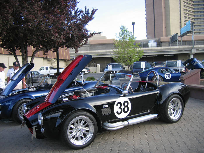

I have the 17" on my SPF. 9.5" front and 11.5" rear. Michelin pilots currently going to the PS2 Michelins. If you want 335 rears, these are it. You would have to go to the 315's. I have knock off's with the adapters.
These are the new shoes!$$$$

17" wheels will work on any brand Cobra. Remember, 17" wheels and15" wheels are basically the same size once they're installed. 15" tires have a taller sidewall and 17" wheels will have a shorter sidewall.
