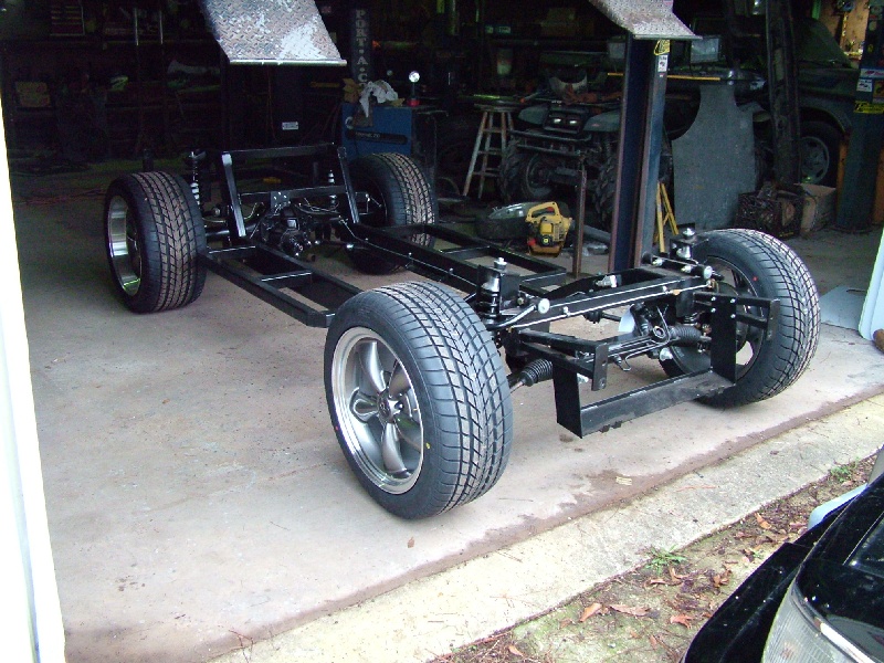

Default A&C rolling chassis
So easy to build, it was almost to easy. I finished and now I'm waiting on the body.
