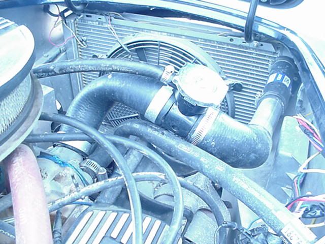

Update....took the expansion tank to a radiator shop to have it torn apart, cleaned up, and re-soldered. Should have it back the first of the week. Of course my first weekend at home without the car was not going to do! Picked up a coolant filler, section of hose, and a cap for $30 at a parts store. She is back on the road!!! Took it out for a long drive last night, did not over heat or stall. Discovered this morning when I let it idle to see if it would overheat that the fan was not coming on! Rewired the fan to a switch in the dash and will drive the car today and see how it goes.

Ran the car all day today and it never got over 100c and typically ran around 70-80c. Although when I rewired the fan to a switch in the dash the wire I used was too small of a gauge and it melted under the dash....nothing worse than driving your car and having small puffs of smoke coming from under the dash! Re-wired it with thicker wire at the hardware store. Seems to be holding, but the wire still gets pretty hot. I know there is a thread here om fan wiring that I will need to look at. otherwise, it looks like we are in business.
