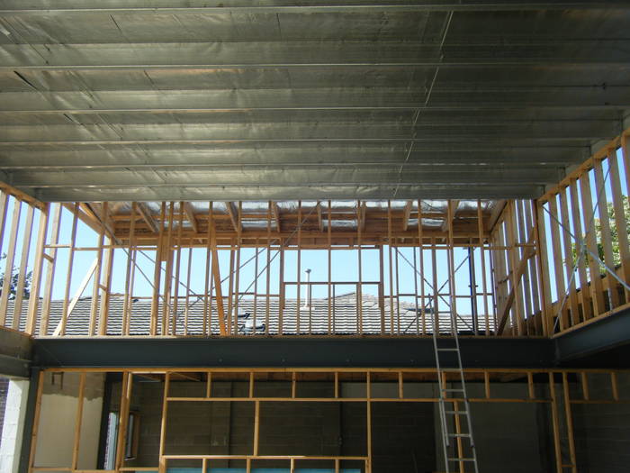

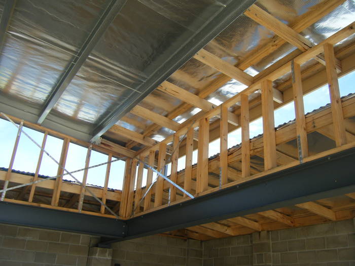

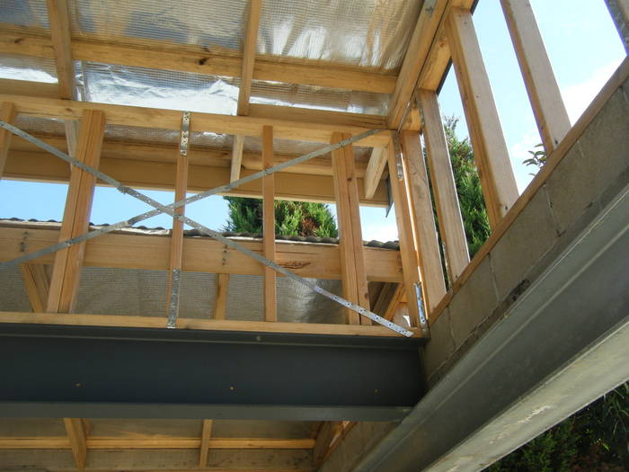

Stiffy, great work. Just a quick question. In the 1st and 2nd pics the lower roofs butt up against the pine uprights that extend up to hold the main roof. Shouldn't there be a flashing that runs up the pine 200-300mm that would get covered by the wall cladding and under the iron on the lower sections by a similar amount?

Well spotted, they left them on the factory floor and delivered them last week. They fitted them today.
The sparky did alot of the set out and the builder did a bit before the heat arrived.

What are those flashings for? Pardon my ignorance.

The flashing is so water will not leak through the blue board ( I think ).

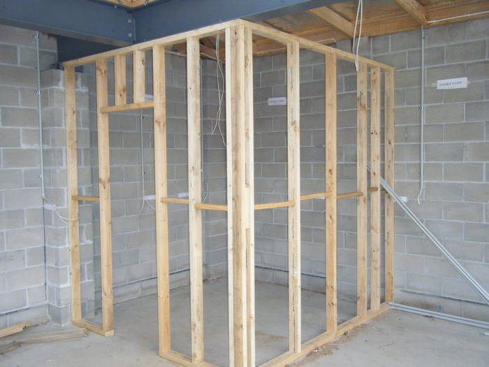

Mr Postit Note  the sparky wanted all the points and lights marked,,,

Providing a penetration for ventilation in the grinding/welding room?

yes that looks like it makes sense, I didnt think it would go UNDER the tin

You obviously haven't seen me weld
Yes there will be a vent, just need to get the final inspection done.....
