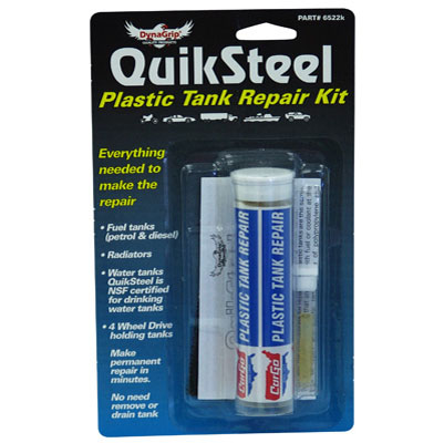

While tidying up the yard and using the brush cutter, I sat it down while replacing the nylon blades on the quick change head, when I sat it upright again I noticed a fuel leak.
The plastic tank has gone brittle and has alot of crazed cracks through it and 1 leak.
I have contacted Makita regarding a new tank but suspect they will tell me no parts available as it is outdated model.
I would prefer to keep it as it is in really good nick apart from the old fuel tank.
I recently had it apart and the piston and bores are near perfect, it starts and runs beter than any others I have had.
So if I can not get a tank is there a product I can use to seal the tank with?
I would prefer something clear but would use something not clear if it will work, flexable would be good.
I am guessing it would be something that is a 2 part sealer, mix together and pour into tank, move it around to coat all surfaces and pour out excess fluid.
Thanks for any tips.

Check out the POR15 website, they have a fuel tank repair product for motor bikes, i think its for metal but it may be worth reading it.

Hi Boxhead,This from Supercheap auto.

Zedn, I have emailed POR and awaiting there reply.
Victor, I will stop in at Supercheap tomorrow, and see what they have.

Looking at the instructions on the website, it says 'instructions for metal tank only' then there is an asterix that says call about other types of tanks.
Not sure if you saw that.

Yep I saw that, thats why I emailed, figured Monday is a holiday here so no point ringing Oz dealer,and direct supplier will probably know more.

sikaflex will do the job have had it on my plastic truck tank now for about 2yrs and shows no sign of wear

Kreem tank sealers have been around a long time.
http://www.kreemproducts.net/p-17-kreem-combo-pak.aspx

Had the same problem with my Kubota brush cutter, awesome machine but the fuel tank cracked. I chased everywhere on the phone for a replacment tank but no luck. I took it to a couple of mower shops and found one that was exactly the same from I think a Sthill.
