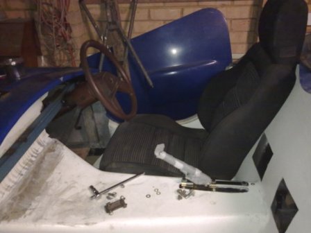

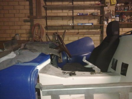

I thought i had finished my steering column and pedals, but then when i bought my motor i found the pedals were in the wrong spot. Whilst moving the pedals, i had to move the steering column, i then some how got onto moving and replacing the cross bar. Any way finally finished it this weekend and now a lot happier with the result. I bought a TIG since last time so its a lot stronger and neater. The pedals are reverse swing with remote reservoir so the master cylinders wont be visible in the engine bay.
I am happy with the feel of the current position of the steering wheel, but i am worried that the angle is too flat. Does the angle of the wheel look funny in these photos? I think i will wait to look at some cars on Sat before making any modifications.

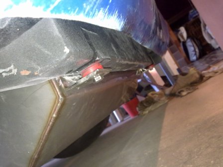

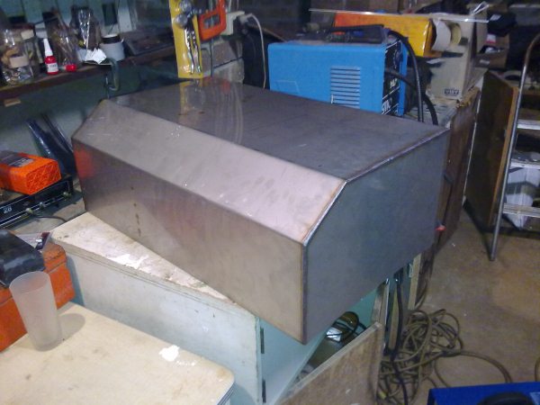

I have also got my fuel tank completed and mounted now. The tank still needs polishing, but i am pretty happy with the result. Capacity is about 91lt

Steering wheel position looks fine to me.
Looks like your doing some top quality work there keep going.

Thanks Cameron and thanks for the feedback on the wheel position. Im starting to think it may be just the big 15.5" ugly holden wheel thats putting me off.

My steering wheel angle looks pretty similar to yours, I reckon a slightly smaller wheel will make things look more in proportion though.
