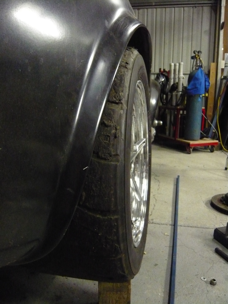

I am planning to go to 245 45 17 and 285 40 17. I know that you can get 315 35 in the rear however I would expect that this would depend on the brand as the pic below is a comparrision of 315 35 17 for a Sumitomo and a Goodyear eagle show is the size difference.

Leroy, I beleive the tyre width (ie 315) relates to the tyre being on a particular size rim not on its own. I would expect if you put both those 315 tyres on a 10" rim they would be the same width as the bead will blow out to seal on the rim. I have the sumitomo on an 11" rim and they measure about 313mm. The shape of the wall will make a difference from that angle as the actual tread width may vary, but the width of the tyre is the width for guard clearance.

The 315 is not a good fit on a 10" rim in my opinion. The sidewall is definitely pulled in and I reckon you loose some tread footprint from this. It's an ideal fit on an 11" rim.
These are Yokahama ADVAN 315's on 11" rims
These are Sumitomo 315's on 11" rims. Note the nice straight sidewalls on both tyres.

Thats great to see them fitted and to 11" rims, straight sidewall fitment. Looks good.
