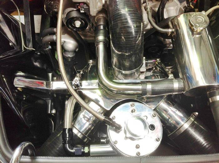

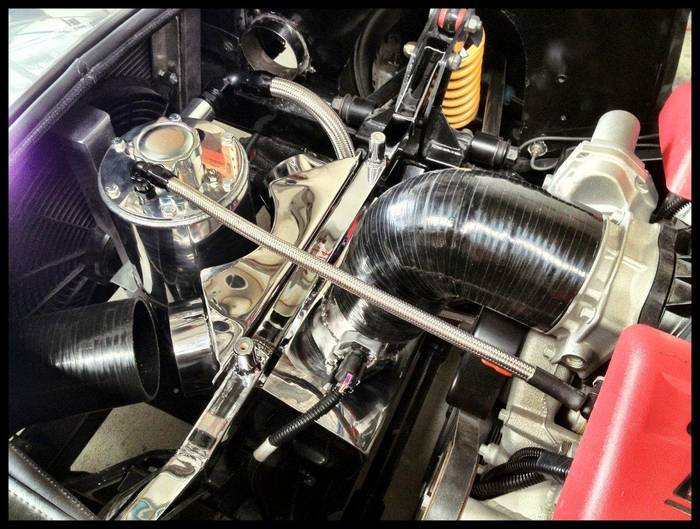

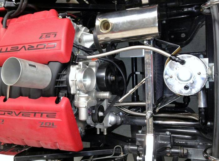

Great work Wazz - the intake looks great - where is the cold air coming in?
Both front brake ducts are fully enclosed / boxed off, under the wheel arch, and fresh "outside" air is then directed through two 100mm holes in each side of the firewall..and fed into the front half of the air box.
Then there's a vertical air filter panel separating the front half from the back half...and the engine sucks air from the back half.
Hope that makes sense !
Here's some pics showing the "mock up" and making sure everything was going to fit first.
Here's a couple showing the "Before" and "After"

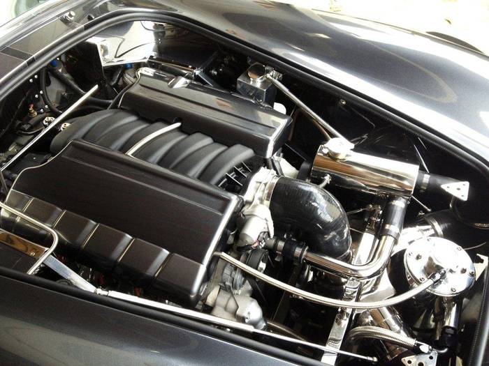

Also really happy with the removable Covers that we ( Warwick Harrison ) made so that the suspension wasn't visible looking into the engine bay.
That always bugged me on the previous Cobra.

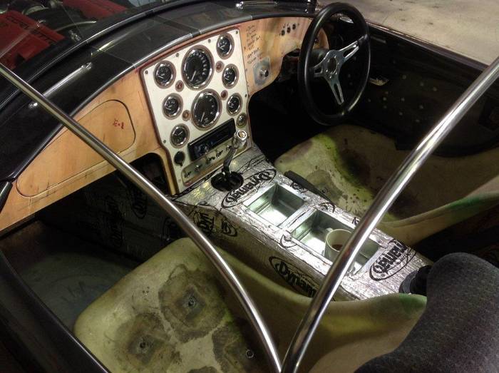

FINALLY getting near the end...
Well...didn't that FOUR years fly by ?....Lucky I've had the Race car to get my Cobra "fix".
Anyway....
Not long now,
After the trimmer who PROMISED that the interior would be done in three weeks...took three and a half MONTHS so far...and should be all done "in another week or so"
APPARENTLY I had to wait until the German Cows that had my leather on them ....died.
It must have happened recently 'cause everything has arrived...and all the panels are now done and just need to "throw in the carpet and leather ".
The dash is done, and some of the centre console/foot wells etc.
I hope that the next post will be me jumping up and down because it's all done...but I don't want to jinx it, so I'll just throw in a couple of pics of stuff we did today, and some other bits of the dash etc.
FINALLY got around to changing those Chevy engine covers...they still have some polished stainless panels to be fitted yet...but I'm happy with how they look in the engine bay so far.
And...

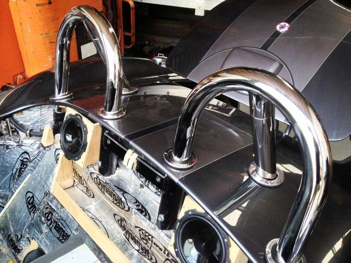

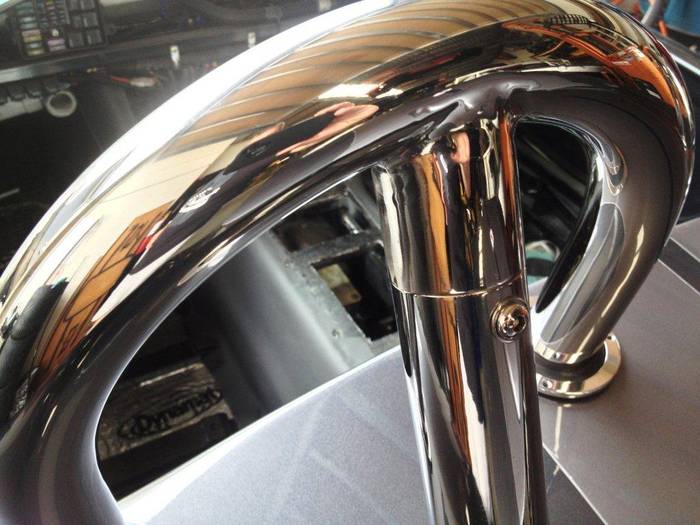

The roll bars...they've been sitting there for two years...but hadn't been cleaned up and polished until now.
Scotty got to them and cleaned up the welding, and polished them to perfection.
Also asked Scotty to make some oval shaped besels for the rear stays , so that they look like they would match the look of the other besels...REALLY happy with the job.
Hoping my idea of the panel in the middle of the dash...holding all of the gauges will look o.k.
( I know it's not everyone's cup of tea...But I'm trying something a bit different)..
so I'll be happy if it looks o.k., when we get all of the interior done, and hopefully it will look how it does " In My Head"...If you know what I mean.
