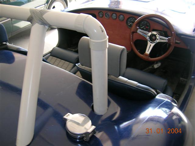

I have a full single rollbar as per pic below. I would like to make it removable so a tidier one can be made later on and coated or chromed.
The 50mm plastic pipe is easy to work with but will soften in the sun I fear so I will go metal. That way I just burn my hands.
If you were to cut the rear stays would you go for in internal or external sleeve? Use solid rod or hollow pipe for an internal? Full through bolts or embedded grub/ set screws?
I will make my join just under the rear deck fibreglass because the angled stays will lengthen as the bar is pulled up. The bottom floor plate will be unboltable and free to jiggle while the bar comes up. How much gap can I cut around the stays and be sure a store bought bezel will cover it? Only the rear of the hole needs to be lengthened.

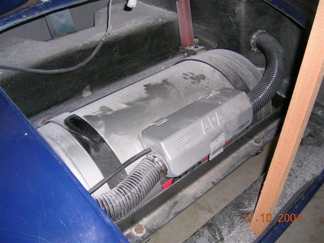

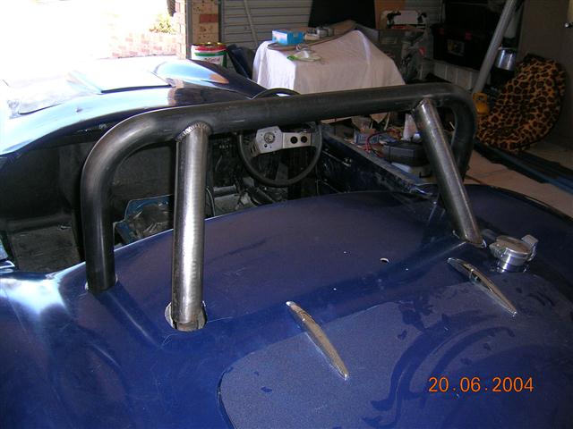

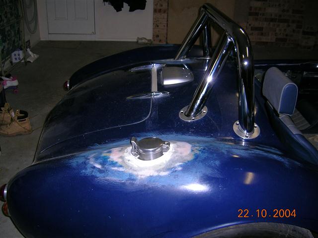

This may help. Back stays are inside the main legs and join just under the body. Small piece of pipe welded inthe leg the sleeved external down onto chassis. Will never be removed I don't think but can be with abit of work.
Nothing wrong with plastic .
Bezels are aluminium cut to size to cover holes.

WOW, once chromed ya wouldn't even pick it as plakky pipe.
Thanks for the pics Brett, they give me a guide.

Unfortunately I can't adapt that method due to my close fitting fuel tank. I will keep it in mind when I'm sitting in the boot again today though.
