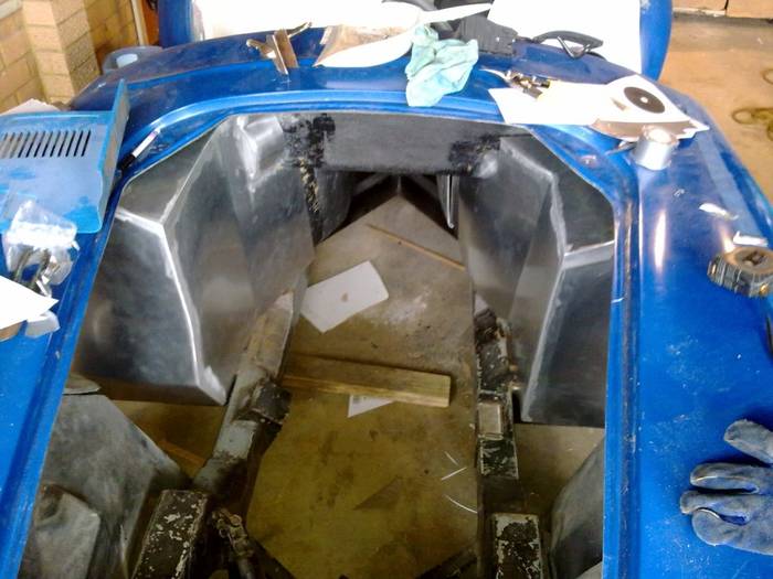

This is what i have done so far.
Still have to cover the fire wall and remake the inner guards.

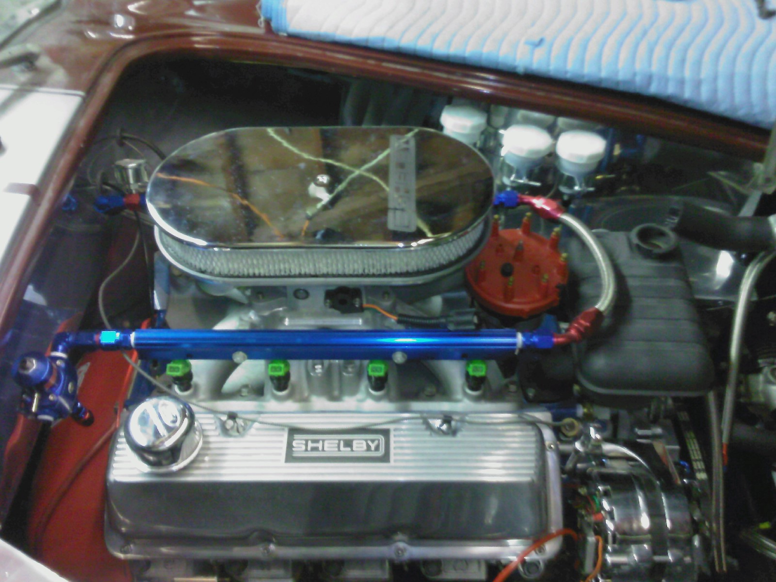

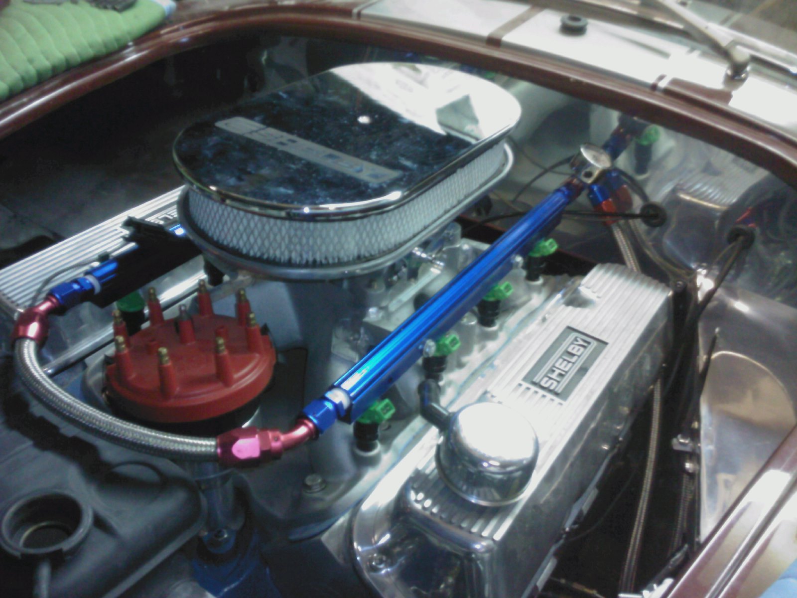

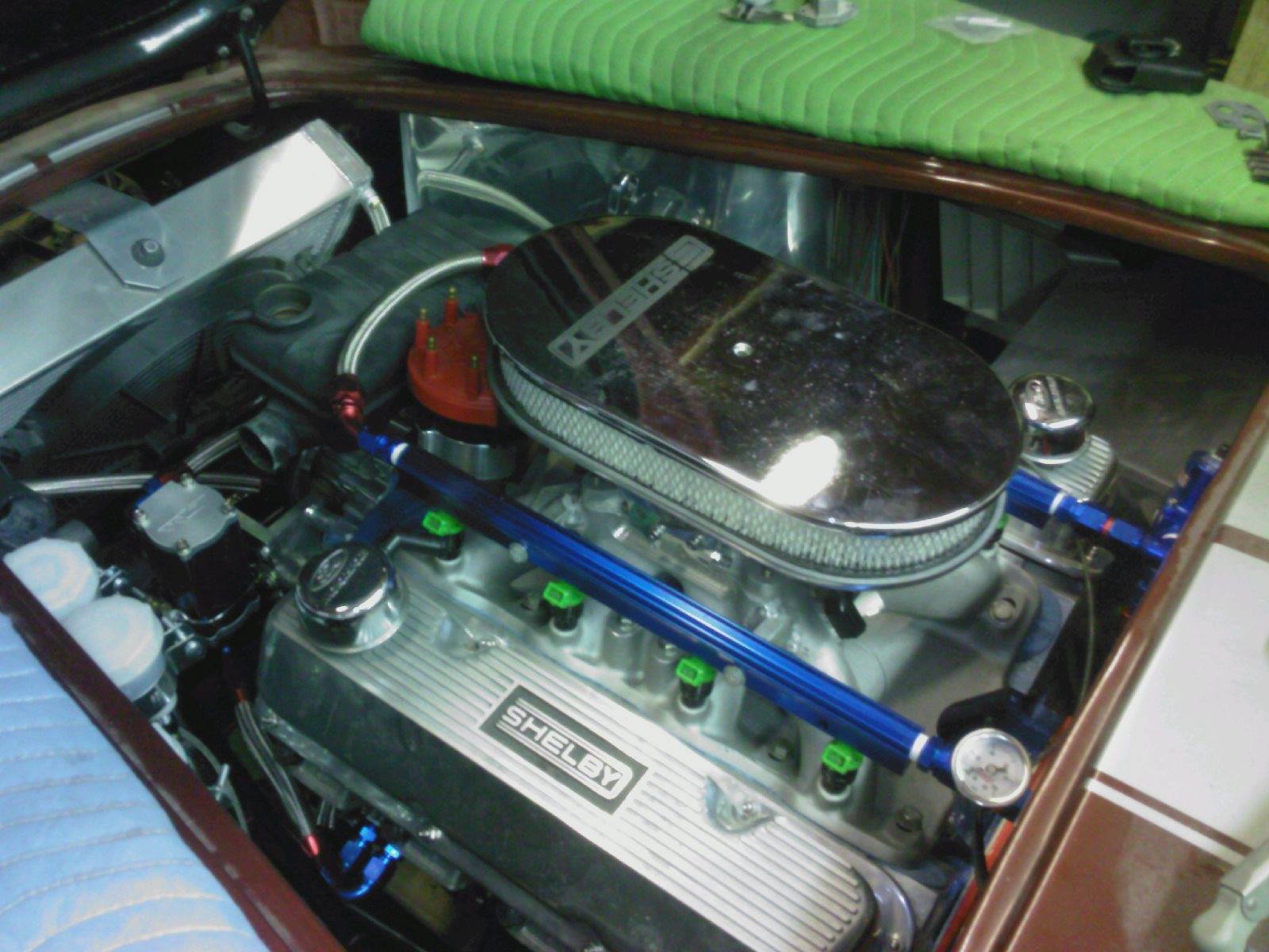

Pic of Aluminum a few years ago.
