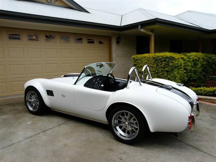

Some photos taken today.....
Geoff

They look pretty much the same as mine Geoff.
Went through Rego with these nuts on in place of the spinners. Thanks Phil N for the loan of them. These ones are aluminum but I believe you can get them in Stainless steel now.
