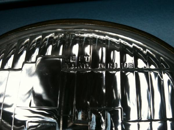

Well thanks to Mr. Boxhead another set of tripod lights arrived from the UK today. This presents a unique oportunity to show some pics with a light made for the US market (bought from Finishline) and a light made for the UK market. Both are manufactured by Lucas England.

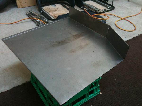

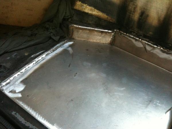

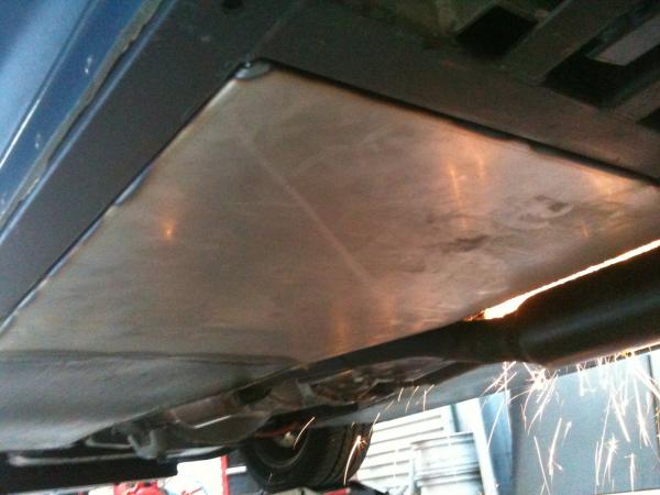

So the floors have now been cut out and the new plate sections have been welded in place. Only one small fire in the cockpit due to the tunnel trim but apart from that it all went smoothly. Tomorrow will see the undercoat and sealant applied and then it will be time to bolt in the seat runners and then the seats. Might even take it for a little blat if the rain holds off

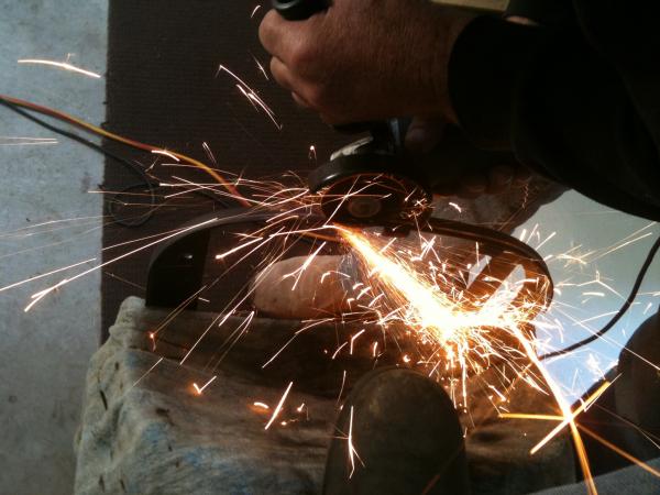

So there is a little bit to catch up on. The lowering of the floor has been completed which is a complete succes
The undercoat after grinding
Sound deadener
Undercoat underneath followed by masking and Stoneguard
Adjusting the seat angle
The result = 80mm gain

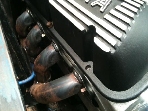

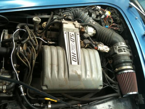

So the basic donk is in, engine bay has been stripped and the custom headders are ready to be ceramic coated. The exhaust has been rebuilt with bungs and flanges in all the right places and 1 central high flow cat. The coating should be done and the engine should be out by the end of the week. Then it's off to get the engine bay done.
Before:
Current:
We've decided to try and resurect the original bonnet so I've removed the wide scoop for the standard HO manifold so that we can cut the correct sized hole for the new setup. I've ordered a scoop that I think might fit but in may need to be modified.. We will see.
There might be a hold up with some of the interior (and perhaps exterior) work, so we might just get the new engine run in before we make changes to the dash etc. But, it's all coming together.

Is that one of those elec fuel injected manifold that looks like a carby setup or is it actually a carby setup? Either way it looks awesome
