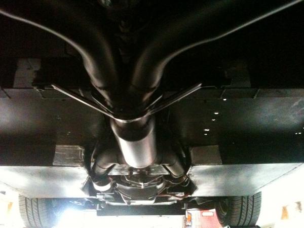

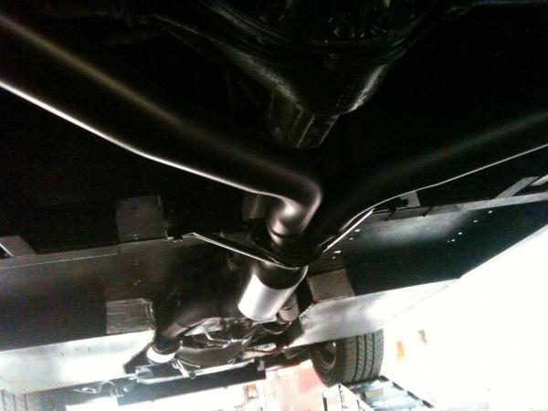

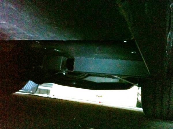

So... Today I picked up the cobra from True Flow Exhausts in Sunbury. I asked them to change the under body exhaust system from the original twin config of Headers to the cats to a muffler under each seat then through the rear cross member and then out on either side of the drop tank.
So now it runs from the headers into two new stainless cats, then a flange, then both pipes flank the gearbox housing until they come together in a collection cone directly underneath the tail shaft. This single pipe then connects to a hot dog and then continues to travel underneath the tail shaft until it passes under the rear cross member. It then divides into two pipes, then another flange, a cylindrical muffler on either side of the drop tank and they finish with a little dumpy pipe just below the rear body line.
Ben only used mandrel bends and the system looks good. Unfortunately he had taken it off the hoist before I picked the car up so I didn't get any pics. I will take some soon.

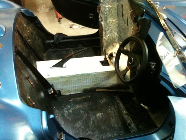

Having arrived home I set to work removing the seats, interior trim and insulation where I will need to modify the floor.

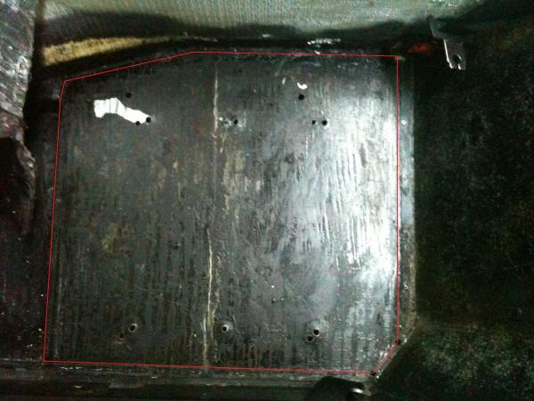

I only had a little time today so I decided to measure and mark the floor for cutting. After drilling a few holes to confirm the location of the main structural members (yes, I am a chippie, it shows doesn't it ) and jacking the car up onto ramps and stands I am confident that I have a good plan of attack.
Fortunately the site forman was on hand to give me some vacant looks of encouragement. Or maybe he was hungry? I'm not sure..
At least I was able to take some reasonable pics of the new central exhaust and give a better account of the current config. of the area that will be modified.
I hope to be able to put my new reciprocating saw to good use on Friday if this day job thing doesn't keep getting in the way.
